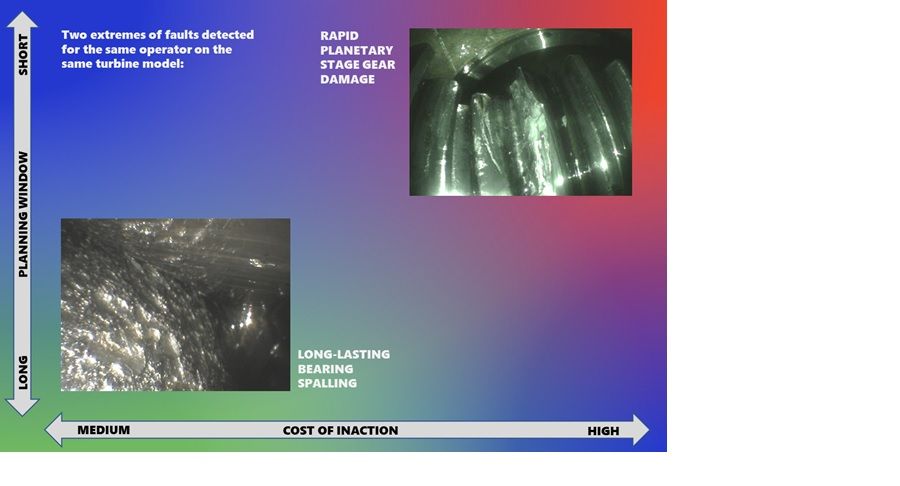

This article shows two cases, the “extreme ends” of turbine condition monitoring, as we might call it. The first case shows the degradation of the gearbox high-speed bearing. ONYX’s analytics allow for very early detection, when the first spalls were forming on the bearing. We see these failures often and know there is no rush to act. The site was notified “inspect when convenient (3-6 months).” They did and we’ve watched the issue with the site manager for three years. Finally, the time came to replace the bearing, giving a remarkable 1,100 days of lead time.
