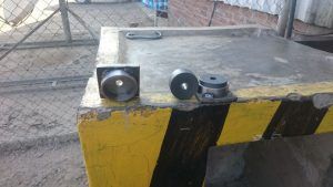

Grosch’s engine-mounting solution was to make a metal cup holder into which a Vesconite disc is bolted, and on which the engine sits.
Through these means, vibration was lessened and steel-on-steel wear was eliminated. Vesconite also provided the advantage of being dimensionally stable and resistant to salt water, which were boons for the tour company, which had to chisel off salt off the original water-absorbing nylon support base in the past.
