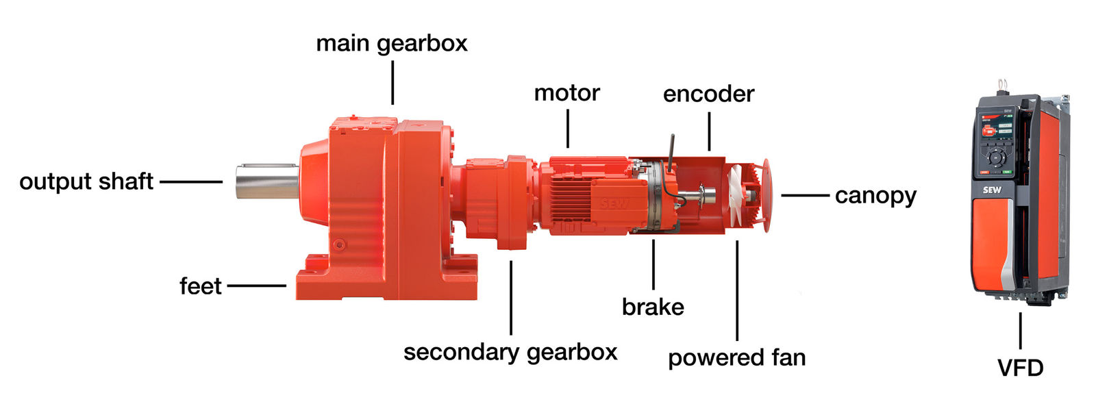

A drive and some of its optional accessories.
A drive and some of its optional accessories. All photos courtesy SEW-Eurodrive.
Happily, there’s a simple solution to this problem: ask the right questions before sitting down to the selection tool. Thoughtfully defining the problem and organizing the application’s requirements paves the way to a smooth and successful selection experience. This article outlines the questions you should ask yourself as you prepare to use a drive manufacturer’s selection tool.
The Drivetrain
The drivetrain contains everything that powers the application, including the drive itself. The drive (pictured above) has three core components: a gearbox, an electric motor, and a variable frequency drive (VFD). It may connect directly to the application, or it may deliver power through additional transmission elements, such as a belt, chain, or spindle. In either case, the drive must have appropriate coupling and mounting devices. These include flexible couplings, flanges, feet, or torque arms.
The motor may require a brake, either to stop the load or hold it in place. If the application requires precise speed control or accurate positioning, a motor encoder will be necessary. When a PLC or other industrial controller manages the application, the VFD will probably need a suitable fieldbus interface or some extra inputs and outputs.

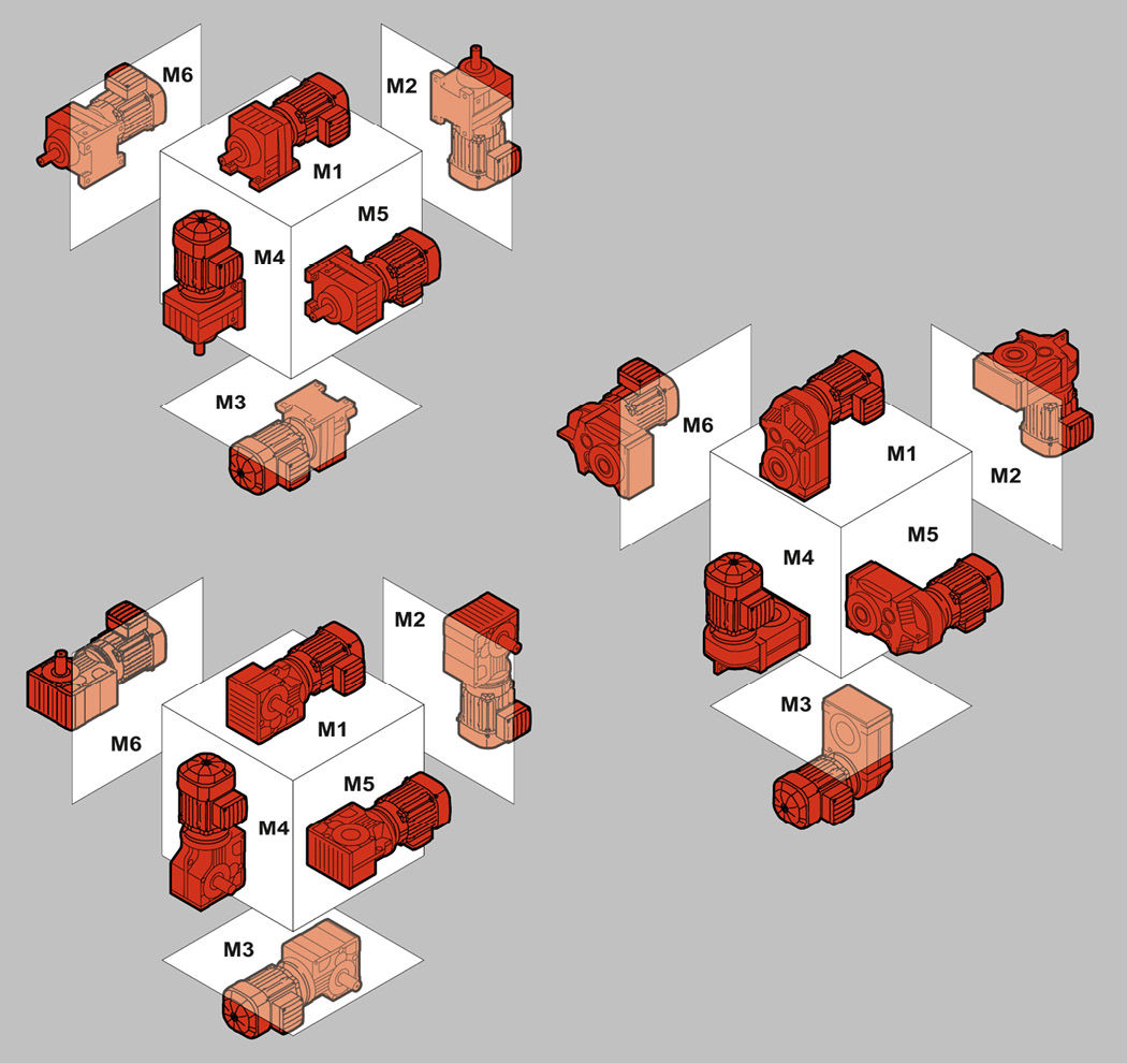

Gearbox mounting position identifiers vary among manufacturers. This is SEW-Eurodrive’s system.

Similarly, the gearbox mounting position influences efficiency since position determines how much oil the housing must contain to keep the gear stages lubricated. Vertical mounting positions often require more lubricant, which leads to higher churning losses as the gears plow through the oil. Whenever possible, select a mounting position that requires the least lubricant. Every manufacturer has its own mounting position identification scheme (pictured above right). Be sure that you understand it, so you can correctly specify the gearbox mounting position.

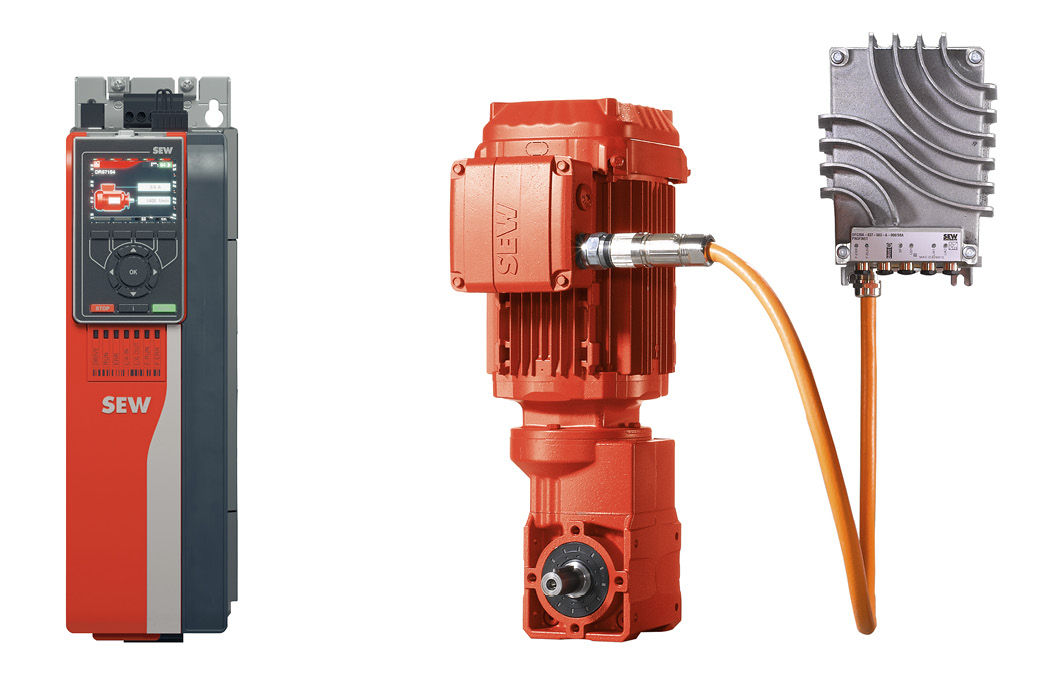

For the final core electronics question, determine how the VFD will integrate into the application. Many VFD manufacturers offer their products in two styles: control cabinet and decentralized (pictured above right). A control cabinet VFD, as its name implies, lives in an electronics cabinet. Wires enter and exit the cabinet, connecting power, the motor, and any sensors to the VFD. The cabinet protects the VFD from the environment, especially important when operating under harsh conditions.
Control cabinet (left) and decentralized (right) VFDs perform the same task but in completely different ways.
Decentralized VFDs approach control differently. They mount either on the motor itself or very close to it. Since they’re exposed to the application’s operating environment, decentralized VFDs usually have relatively high IP (ingress protection) ratings, such as IP66 or higher. A decentralized VFD integrates more seamlessly into the application and typically requires less wiring since it mounts very close to the motor. Decentralized VFDs are becoming increasingly popular in many industries. Some drive manufacturers even offer “electronic gearmotors”—an all-in-one gearbox, motor, and VFD (pictured below). These offer an especially elegant solution to many drive challenges. As a bonus, some are exceptionally efficient because they combine a super premium efficiency (IE4) motor with an efficient gearbox and VFD.

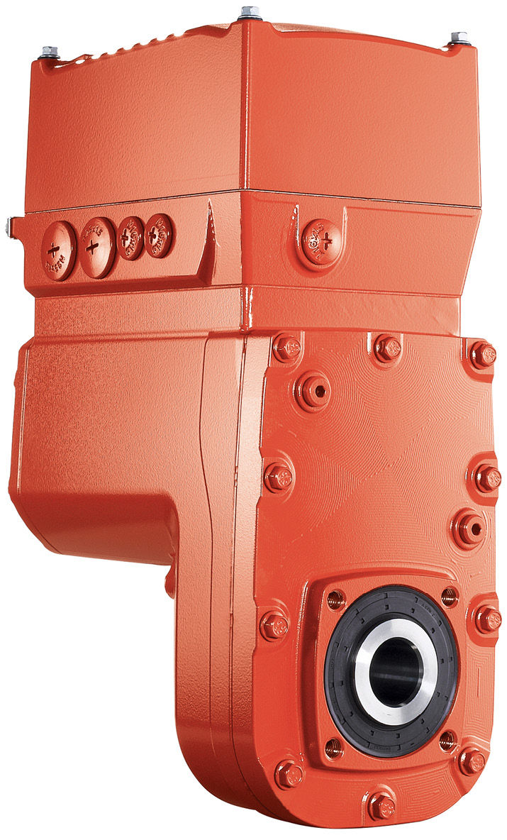

A highly efficient electronic gearmotor integrating a motor, a helical-bevel gearbox, and a VFD.
