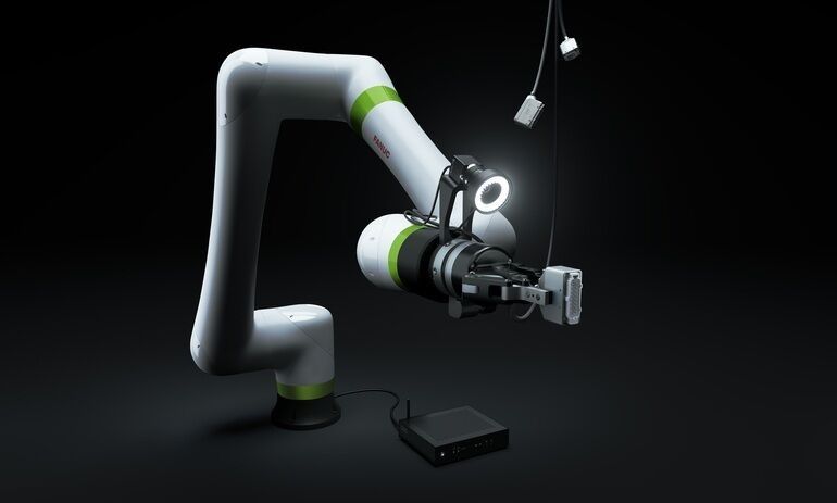

Micropsi Industries recently announced that its artificial intelligence (AI)-based software MIRAI is now compatible with numerous robots produced by FANUC, a leading supplier of robotics and factory automation in Japan, and its U.S. subsidiary FANUC America. With MIRAI, FANUC customers can now add valuable hand-eye coordination to multiple FANUC industrial and collaborative robots (cobots) to handle difficult-to-automate functions such as cable plugging and assembly.
Using AI, the MIRAI controller generates robot movements directly and in real-time. Robot skills are trained, not programmed, in a few days through human demonstration, without requiring knowledge of programming or AI. To train a robot, a human repeatedly demonstrates a task by manually guiding the robot by the robot’s wrist. The recorded movements are then transformed into a skill.
