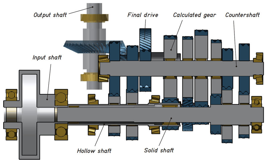

The following example will discuss the influence of the load-dependent center distance on the meshing of a dual-clutch gearbox. Figure 1 shows the cross-section of the 3D gear model in the FVA-Workbench gear design software. The gearbox consists of the double clutch at the gearbox input, which engages either the hollow shaft for the odd gears or the solid shaft for the even gears. Idler gears are mounted on the countershaft. The power is transmitted out of the gearbox via a bevel gear stage.
Figure 1: Simulated cross-section of a dual-clutch gearbox in the FVA-Workbench.
Since the greatest deflection is to be expected in the center of the countershaft, the second gear is considered the critical gear and is discussed in the example below. The gearing is designed so that the pressure is as uniform as possible and does not exceed a maximum value of 1500 MPa. The applied modification ensures that no load or pressure peaks are to be expected on the flank.

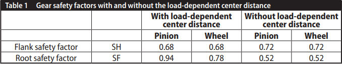

Due to the flexible design of the countershaft, the meshing forces push the teeth away from each other, which reduces the contact ratio. The average number of teeth transmitting the load is reduced correspondingly. This has a negative effect on the safety factors. In this example, the design criteria were defined exclusively by the pressure, and the safety factors according to ISO 6336 (without consideration of a load spectrum) are correspondingly low.
Table 1 shows that the flank safety factor is slightly reduced by taking the load-dependent center distance into account. However, the root safety factor increases significantly. This is due to the fact that the lever arm for the meshing force is increased, so that the load is smaller. However, the bending moment arm on the tooth increases, as the overall load is higher. In this case, the load-dependent center distance has a positive effect, but there can also be cases in which the tooth root safety is reduced. Thus, it is essential to take the load-dependent center distance into account.

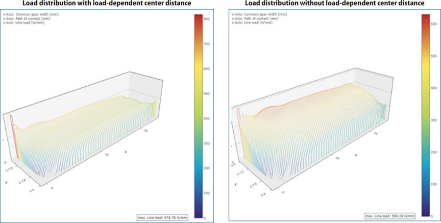

The microgeometry of the gear plays a key role in the load and pressure distribution. Figure 2 clearly shows that the gear was designed without taking the influence of the load-dependent center distance into account. If this influence is considered, the load distribution in the direction of the mesh is no longer uniform, but increases significantly.
Figure 2: Representation of the load distribution with and without the load-dependent center distance from an FVA-Workbench output report.

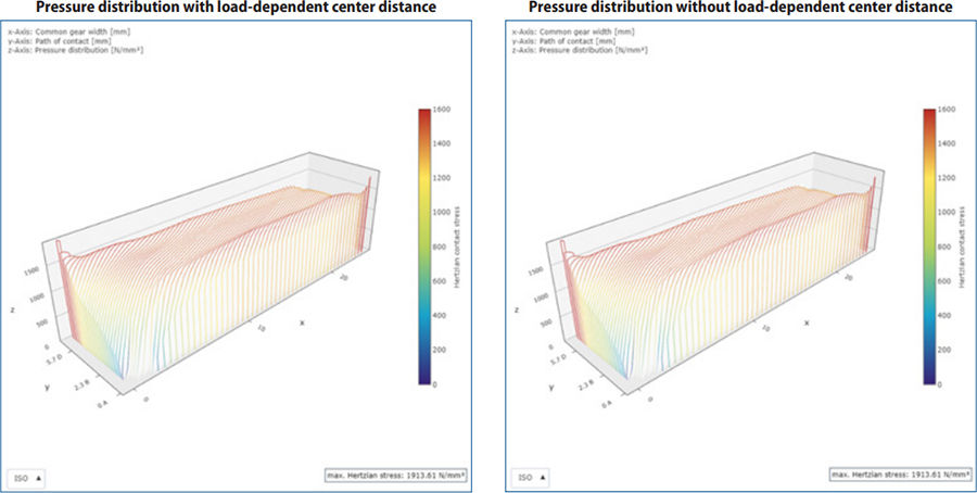

Figure 3 shows a simulation of the pressure distribution from an FVA-Workbench results report. Excess pressure can be seen at both the beginning and end of the mesh due to insufficient tip and root relief.
Figure 3: Representation of the pressure distribution with and without the load-dependent center distance from an FVA-Workbench output report.

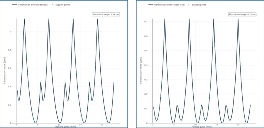

Influence on the noise excitation
One evaluation criterion for the noise excitation is the transmission error and excitation level. Transmission error occurs as a result of fluctuating stiffnesses in the gear and different loads, depending on the mesh position. The excitation level is formed from a weighted sum of the individual frequencies of the gear, with an emphasis on the audible frequencies. This is described in FVA 133 â€” Overlap ratio, FZG â€” TU M¼nchen.
The influence of the load-dependent center distance becomes even clearer if the transmission error is calculated from the represented load distribution. The range of variation of the transmission error increases by more than 50%, while the excitation range increases from 16.79 dB to 19.35 dB. It can therefore be assumed that this gearbox is significantly louder than one in which the load-dependent center distance is considered in the design.
Figure 4 shows a simulation of the transmission error with and without the load-dependent center distance from an FVA-Workbench results report.
Figure 4: Representation of the transmission error with and without the load-dependent center distance from an FVA-Workbench results report.

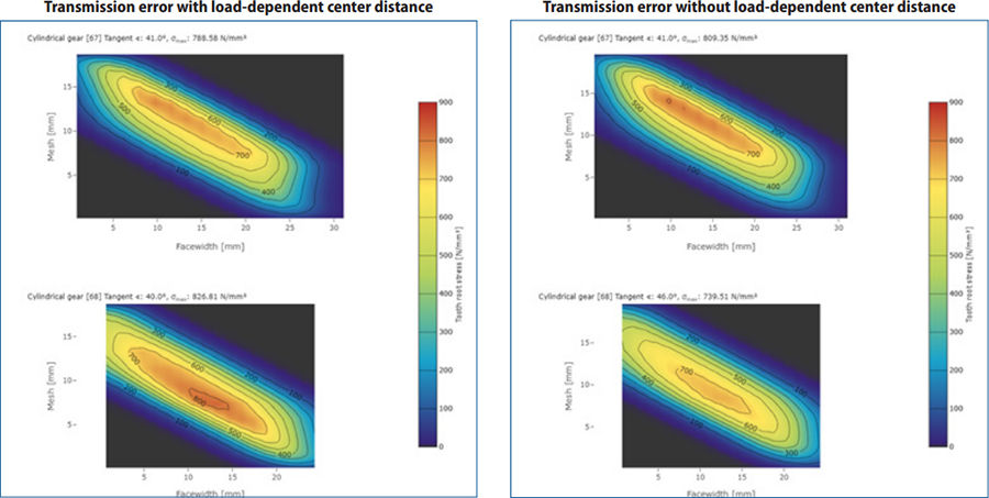

FVA 264 offers a method for further consideration of the tooth root stress, in which the local tooth root stress over the mesh can be solved using the BEM method. Figure 5 shows a simulation of the tooth root stress with and without the load-dependent center distance from an FVA-Workbench results report.
Figure 5: Simulation of the different tooth root stress with and without the load-dependent center distance from an FVA-Workbench results report. The opinion is shown in each image.
Analysis shows that the tooth root stress on the wheel increases from 739 N/mm2 to 826 N/mm2 when the load-dependent center distance is taken into account. At the same time, the stress on the pinion decreases slightly from 809 N/mm2 to 788 N/mm2.
