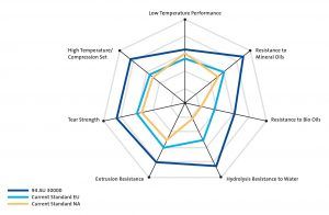

Freudenberg Sealing Technologies’ 94 AU 30000 offers excellent performance in heat and cold and can be used in mineral hydraulic fluids at temperatures ranging from -31°F (-35°C) up to 250°F (120°C). It can also be used in biodegradable media. The material is more resistant to water and synthetic hydraulic fluids and withstands major temperature fluctuations better than other existing polyurethane materials.  94 AU 30000 also offers protection against damage from hydrolysis. This new polyurethane material, in fact, meets the market’s requirements for potential universal use.

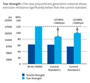

Significantly, 94 AU 30000 is highly effective when used to produce seals that come under extreme pressure. Test results indicate that 94 AU 30000 withstands 45 percent more pressure than the best material in the same class – 7250 psi versus 5000 psi. Tear strength under such punishing conditions is 61 percent higher than other PU materials. In a comparison test at 40 MPa and 100°C with large extrusion gaps, the seals made from this new generation of material show no appreciable signs of wear while conventional seals fail prematurely. This increases service life and resistance to wear. This means that cylinder makers can allow for nearly double extrusion gaps for the same operating conditions, reducing production costs. Or alternatively, significantly greater loads can be accommodated at the same gap width. Especially in construction equipment under severe stresses, this avoids potential damage when the pressure peaks.

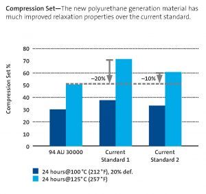

94 AU 30000 functions three to five times longer in mineral oils than standard PU materials and shows no shrinkage or swelling. It functions up to 10 times longer in biodegradable fluids under humid conditions. Extensive compression set, tensile strength and tear strength testing demonstrates that 94 AU 30000 performs better than any current standard material being used in both Europe and North America.
