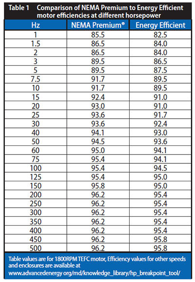

Failed EPAct motors. The decision to scrap failed EPAct
motors and replace them with new NEMA Premium motors
should be based on a lifecycle analysis. EPAct motors are less
efficient than NEMA Premium motors, and no energy savings
are realized by putting an EPAct motor back in service. A
rewound motor could be even less efficient than when it was
new; however, a service center that adheres to EASA good
practice guidelines should be able to mitigate or resolve efficiency
losses. For more information on good practices, visit
the EASA website (www.easa.com/energy).
McCoy contends, “When we do our motor assessments, we
look mainly at replacing standard-efficiency motors — when
they fail — with NEMA Premium efficiency motors. Nonetheless,
depending on operating hours and utility rates, many
times it is also cost-effective to junk EPAct efficiency motors
when they fail and replace them with new NEMA Premium
efficiency motors.” Standardizing on T-frame motors also reduces
the number of motors that must be maintained in the
on-site spares inventory.

Official mandates. Butler at Advanced Energy reminds,
“EISA was signed into law by George Bush in 2007. It covers
many energy-related topics,
including motors, and became
effective December 2010. For
general purpose motors from one
horsepower to 200 horsepower,
EISA raised mandated efficiency
levels above the levels of EPAct
legislation of 1992.” (See Table 1
for comparison of EPAct to EISA
efficiencies at various horsepower.)
Butler continues, “The Department
of Energy is mandated by
Congress to expand the efficiency
envelope for electric motors. It
has done so since 1992 without
using exotic materials and designs,
but it is reaching a point of
diminishing returns. Meanwhile,
the industry, efficiency advocates,
and other stakeholders are
recommending to the DOE that
it consider motors not previously
covered; for example, motors
with mechanical alterations that
do not affect motor efficiency
Gear motors are a good example.”
