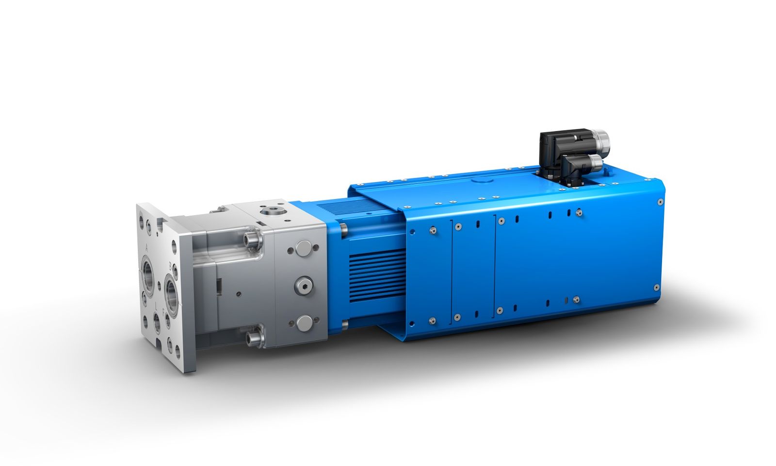

DrivAx IQ4 drives consist of a servomotor with a directly mounted internal gear pump that jointly control volumetric flow and pressure. The system allows for a maximum volumetric flow of 125 l/min and a maximum pressure of 270 bar. The speed-controlled pump drive DrivAx IQ4 combines energy efficiency with high power density and robustness. Unlike conventional, valve-controlled hydraulic systems, the DrivAx IQ4 offers power on demand. Thanks to this power-on-demand principle, the system can operate energy-efficiently at lower speeds in the part-load range and outside the machine cycle. The compact design and interface architecture allow easy integration into machine and control system.
The DrivAx RQ4 consists of a servomotor and directly mounted radial piston pump that together regulate a volumetric flow of maximum 450 l/min at a maximum pressure of 350 bar. The speed-controlled pump drive combines energy efficiency with high power density and robustness. In addition, unlike conventional valve-controlled hydraulic systems, the DrivAx RQ4 offers power on demand. This means that the system works efficiently at lower speeds in the part-load range and outside the machine cycle. This power-on-demand principle in combination with the load-dependent switchable pump allows special load profiles with reduced-size motor and peripherals to be realized. The compact design and interface architecture allow easy integration into machine and control system.
