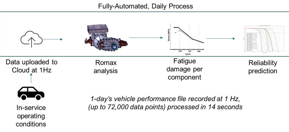

It is obvious how this data can be used as an import to define an “in-service duty cycle,” against which component fatigue calculations can be carried out. Indeed, Romax has been able to import time domain data for fatigue calculations for over 15 years. However, this project provided additional challenges.
The first was to set everything on the cloud and to have it operating without human intervention or human interaction. This is required because, in the end, the digital twin would need to process the data from many thousands of vehicles. The digital twin was set up such that the data was transferred and processed daily for each vehicle. Discussions did take place regarding having more (and less) frequent data transfer; however, it was decided that daily processing would provide the best balance between cost/complexity and insight.
Data integration, the ability to pull data across the cloud and integrate different solutions, was also required. In this respect, Hexagon has assembled a team that spans across its different offerings, combining Xalt Integration with Romax. This now handled by Nexus, Hexagon’s open digital reality platform for manufacturing that is developed to provide connectivity and interoperability across all aspects of design, manufacturing, metrology and in-service operation for all Hexagon’s client industries.
Figure 1—Flow diagram illustrating the processing of CAN data from the vehicle.
Hexagon successfully built the digital twin and as of the end of December 2022, it had successfully processed eight months’ worth of data from 10 different test vehicles, with more being processed each day. The fact of the digital twin’s successful operation is noteworthy. However, of greater interest is what the acquired data has already revealed in terms of how to approach the reliability engineering of gearboxes. This is to be the focus of the rest of the paper.
