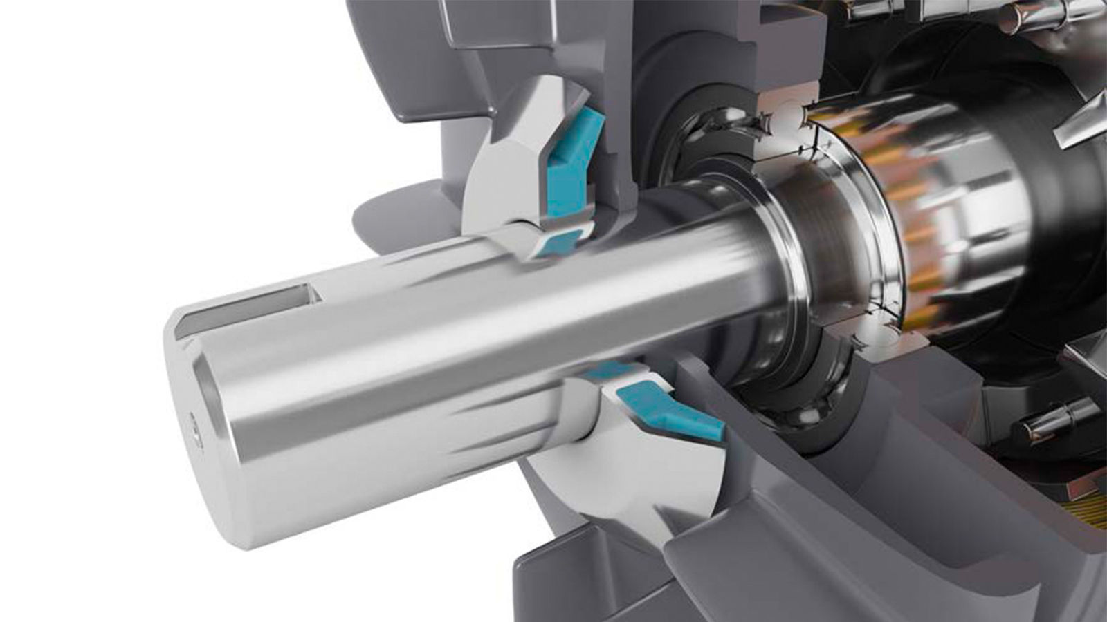

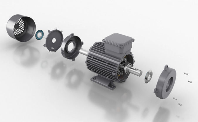

Q: What kind of critical sealing components are needed to address these challenges in electric motors?
As dry running systems, electric motors operate on reduced lubrication versus their gas-powered wet-running counterparts, requiring specific sealing solutions to manage friction and heat generation. Electric systems have fewer sealing components but still require long-lasting sealing products. The seals must protect the motor by keeping oil and grease on the rotating shaft and preventing the ingress of dust and dirt. Static seals such as O-Rings, gaskets, bonded seals and molded parts are used as sealing elements for lids, flange joints, threads and covers.
The type of rotary seal used for high-speed low-friction industrial motors depends on the complexity of the application.
Reducing power loss across the system is another function of the seal, so less energy is required to power equipment or convert into performance. Friction from the bearings and the sealing arrangement both affect power loss, so balancing sealing capabilities with the need for minimal friction is a challenge. A nitrile butadiene rubber (NBR) or fluoroelastomer (FKM) seal usually offers the best solution for reducing friction and power loss depending on the application’s temperature and speed of rotation.
Elastomer radial oil seals are traditionally a primary rotary seal in standard wet-lubricated systems because they have excellent sealing performance and easy installation. However, elastomer radial oil seals struggle to stand up to the conditions of electric motors, such as increased rotary speeds, reduced lubrication or dry running conditions. Elastomer seals also create greater friction resulting in higher power loss.

Q: What unique sealing solutions can Trelleborg offer for electric motors?
Trelleborg’s Varilip PDR radial oil seal is designed specifically to offer superior performance for electric motors operating at higher speeds. It is constructed from one or multiple Turcon PTFE-based sealing elements which are mechanically retained in a precision-machined metal body. The metal body gives a robust static seal against the housing, preventing changes in operating temperature caused by repeated oscillation. Meanwhile, the Turcon sealing element effectively prevents leakage while allowing for motion between the rotating and stationary parts of the motor, leading to excellent performance at high speeds. Characterized by low friction and stick-slip-free running, the seal reduces temperature generation, permits higher speeds at the outer edge of the rotor and lowers power consumption. This results in a long-service life, maximizing the time between maintenance and greater productivity.
