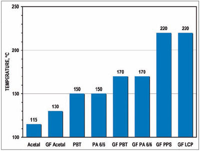

So while plastics gears are certainly different (i.e. better) than they were a decade ago, there are, of course, still limitations — the main barrier being heat. Winzeler summed it up with proper panache when he said that the “nemesis of plastic gears is high temperatures.”
“Delrin is our favorite material, and it does everything we want in a material up to about 85°C,” Winzeler says. “The one thing that is very important to understand about many of these engineering materials is that having knowledge of how these materials process has a dramatic impact on the ultimate strength and durability of that part, and also its long term stability. There’s a lot of science that goes into it once we have a part designed so that we can achieve consistency over very large volumes.
“In terms of gear applications for the amount of work we can do within a certain amount of space, Delrin does everything we want it to do, but it does not do well once it gets over 85°C, meaning it does not work in the engine compartment and it wouldn’t work in the transmission. Once we get into those applications we get into more exotic materials that are more difficult to process.
“The biggest problem with plastics — and it hasn’t changed — is that at some point they melt.”

Most seem to think that, realistically, high-speed, high-torque applications in transmissions are both the present and future of plastic gears due to their ability to eliminate noise at the front end of an automobile.
“Under the hood gears have been looked at for a number of years, and I think manufacturers are satisfied that there are plastic solutions,” Sheridan said. “The only gears in automotive that have yet to be tackled by plastic gears are drivetrain gears. Whether or not that’s going to be feasible, I don’t know. It’s all going to come down to material peformance and material improvements.”

A colorless, organic polymer, PEEK (polyether ether ketone) is a semicrystalline thermoplastic with excellent mechanical and chemical resistance properties that are retained to high temperatures.
More importantly — and most relevant to this particular discussion — PEEK melts around 343°C (662°F). Some grades have a useful operating temperature of up to 250°C (482°F).
In other words, it can take the heat — and then some.
“We got to this point where we’re taking the normal engineering materials — nylon, acetal, etcetera, and we’re beginning to make power gears with them” Kleiss says. “That was all good to a point, but then we got introduced to PEEK, and that is a very unusual plastic.
“It has much higher temperature capabilities than the other materials. You have to mold it at 700°F. In its virgin state, it has a low modulus. Now, low modulus is a detriment in general, because a gear will fail because it bends and breaks. So in a power situation you want a stiff gear to carry a lot of load. But what we began to discover is that plastic fits a niche of gearing in quiet applications — when you have vibrating drives you have to use scissors gears and do a lot of damping and things like that. With plastic, that lowmodulus material sort of acts like a spring. It takes care of a lot of problems just by the nature of the material, if everything else is right.
“About 10 to 15 years ago is when we got our first customer that said, ‘What about this PEEK material?’ That’s when we started working with it and found a fundamental difference between it and all the other plastics. We walked away from fillers and said that we were only interested in [PEEK] in its virgin state, because that’s where we can make the most accurate gears.
“Now we have a material that we think can withstand the kind of temperatures we’re going to expose them to in these high-torque applications. It is able to withstand higher temperatures than any other material that we know of — and heat is the fundamental enemy of thermoplastics.”
