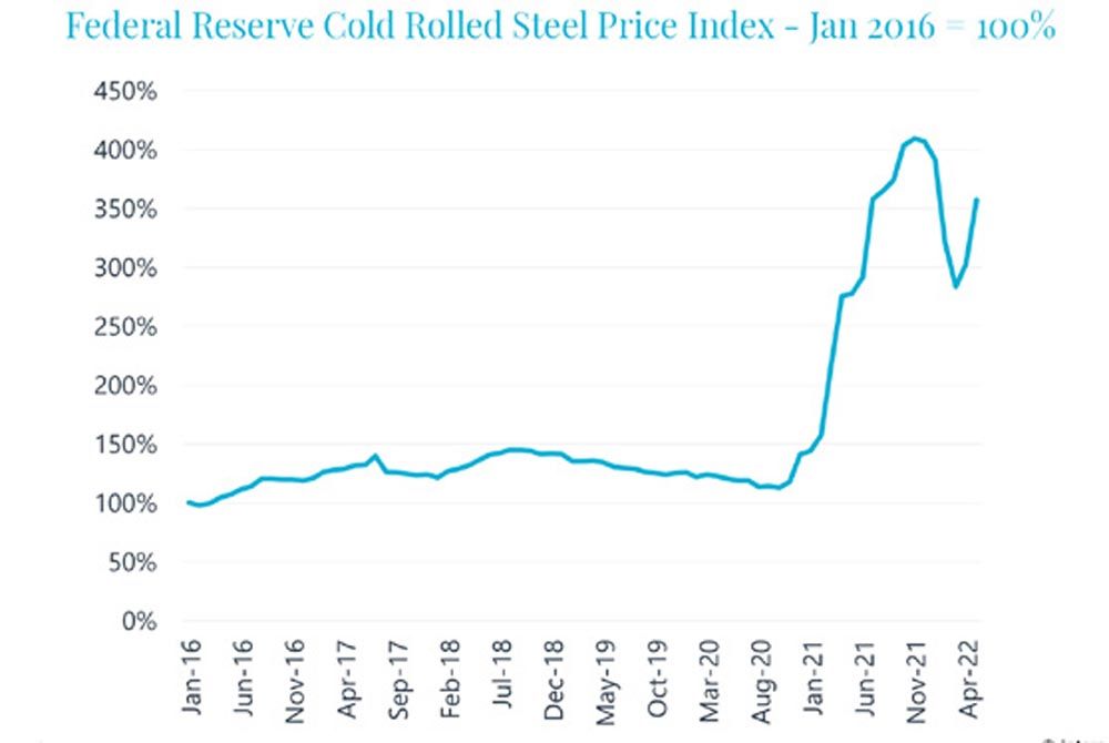

Over the last 1–2 years we’ve seen the price of cold-rolled steel climb to historic levels. The federal reserve tracks the price of cold rolled steel globally. Shown in the right table, the price of the commodity rose to more than 400 percent of its price in January of 2016.
Short term COVID related supply shocks have been one reason for the price performance of cold-rolled steel. However, increased demand from the automotive sector via electric vehicles is, and will continue to be, a contributing factor to the staying power of higher prices. Within electric motor manufacturing, electric steel can make up as much as 20 percent of the bill of material. It is no surprise then that the average selling price of an electric motor is up 35–40 percent compared to January of 2020.

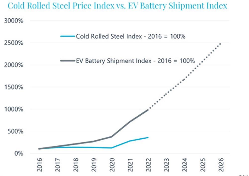

At Interact Analysis, we track the production of lithium-ION batteries used within electric vehicles as part of our ongoing research within the battery market. This series can be used as an indicator for the speed at which electric vehicles are being produced. In the table above, we are showing this series, along with the cold-rolled steel series shown earlier. Showing these together helps demonstrate the relationship between increased EV production and the price of electric steel.
The gray line represents the number of shipments of Li-ION batteries into electric vehicle applications. This is presented as an index value with the 2016 value representing 100 percent. The blue line represents the price of cold-rolled steel presented again as an index value with the price in 2016 representing 100 percent. We are also displaying our forecast for shipments of batteries into EV applications which is represented by the dotted gray bar.
Quickly you will recognize the sharp uptick in battery shipments between 2021 and 2022; hitting nearly 10 times the number of shipments seen in 2016. Alongside this increase you can observe the price of cold-rolled steel ticking up during the same time-period. Our expectations for the rate at which EVs are being produced is demonstrated by the dotted gray line. We expect that over the next five years, the gap between supply and demand for electric steel will widen as increases in production capacity lags the sharp increase in demand for the commodity coming from the electric vehicle sector. This will ultimately result in supply shortages which will manifest into longer lead times and higher prices for motors.
