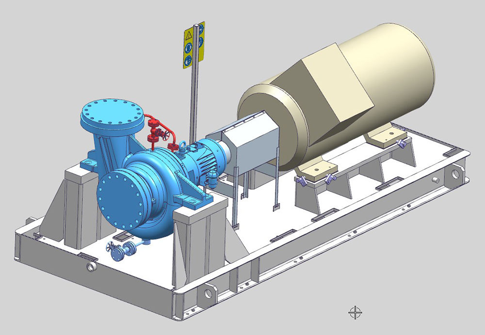

Sulzer presented various solutions depending on the applications along with general arrangement drawings to show how the HPRTs would fit with the surrounding infrastructure. Discussions with the plant’s technical team focused on some of the details as well as the benefits of HPRTs and how they can be easily integrated into the process with the lowest modification effort.

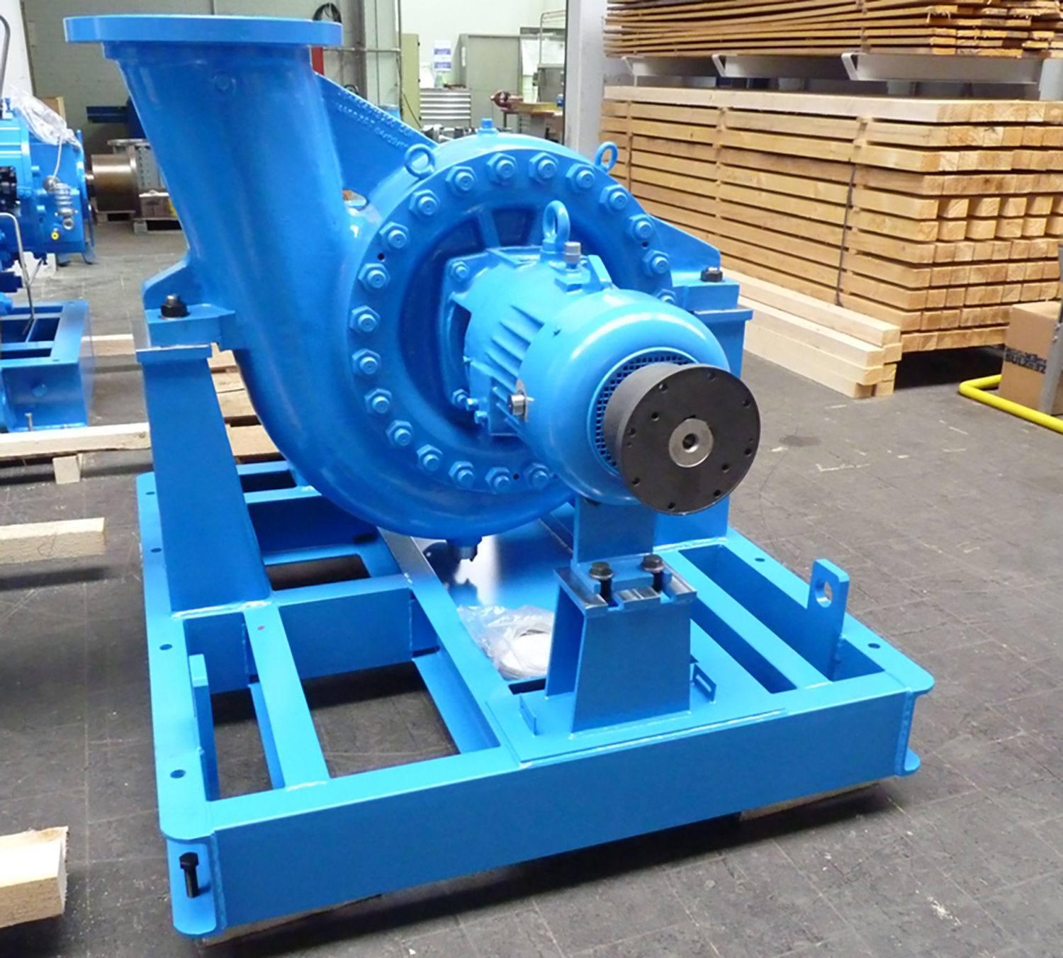

Having discussed the technical issues, Sulzer presented the first solution which would deliver 470 kW from a 10 bar pressure drop with an efficiency above 80%. The energy generated by the HPRT would contribute to the local power grid and calculations could be made to estimate the return on investment (ROI), using the electricity cost the plant had negotiated with the utility.
The refinery operator went into the project with an expectation for the capital expenditure (CAPEX) to be repaid in around three years. This would include any changes to the infrastructure to facilitate the installation of the HPRT. In fact, once the calculations were completed using the numbers from the proposed design, the ROI was less than three years, which was an additional bonus for the customer.
The solution was based on Sulzer’s OH2 API 610 design pump, that is used in many applications across the petrochemical and refining industries. It included a single mechanical seal with Plan 11 sealing system and a direct driven generator. Designed with a stainless-steel casing and a 450 mm impeller, the HPRT will undergo functional acceptance tests at the manufacturing plant in Germany to confirm the 470 kW output as well as the efficiency rating, all witnessed through Sulzer’s online facilities.
