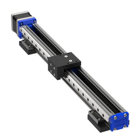

Figure 2: Helix Linear 252 Series linear guide system shown with fully supported round shaft guide rails.

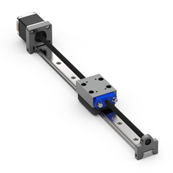

Figure 3: Helix Linear Guide System with single profile rail.
Profile Rails (often referred to as square rails) provide low-friction, smooth guiding systems with high accuracy and stiffness. The square rail design provides support for loads where the center of gravity is directly above the guide rails and also provides the ability to handle moment loads. Square profile rails use recirculating balls in runner blocks called carts, trucks, or carriages that the payload attaches to.
Square profile rails can be mounted both vertically or horizontally. When mounting horizontally, consideration should be given to whether the linear guide system will be mounted flat with the load resting on top of the runner blocks, on its side, or hung upside down. For moment loads, profile rail assemblies are rated differently in yaw, pitch, and roll directions. Therefore, care must be taken not to exceed the load limit based on the mounting position.
If the load is exceeded, utilization of two runner blocks per guide rail can be a solution. However, it may reduce the stroke length or require a longer overall length to achieve the stroke needed. If space constraints are a factor, profile rails can be designed with longer runner blocks to handle higher moment loads. Many profile rail guide systems also have wider rail and wider runner block options available.

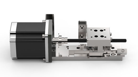

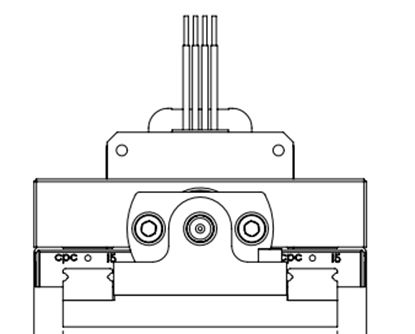

Figure 4: Helix Linear miniature precision actuator with dual profile rail guides.
Profile Rails have more design versatility for mounting due to the flat-mount surface of the runner blocks and tapped holes that secure the base or mating component that is being moved. In addition, profile rails are relatively simple to align when the mating part has a slightly raised milled or ground shoulder to use as a registration edge or datum. The edge of the profile rail can be pushed up against the shoulder during assembly to ensure proper alignment.

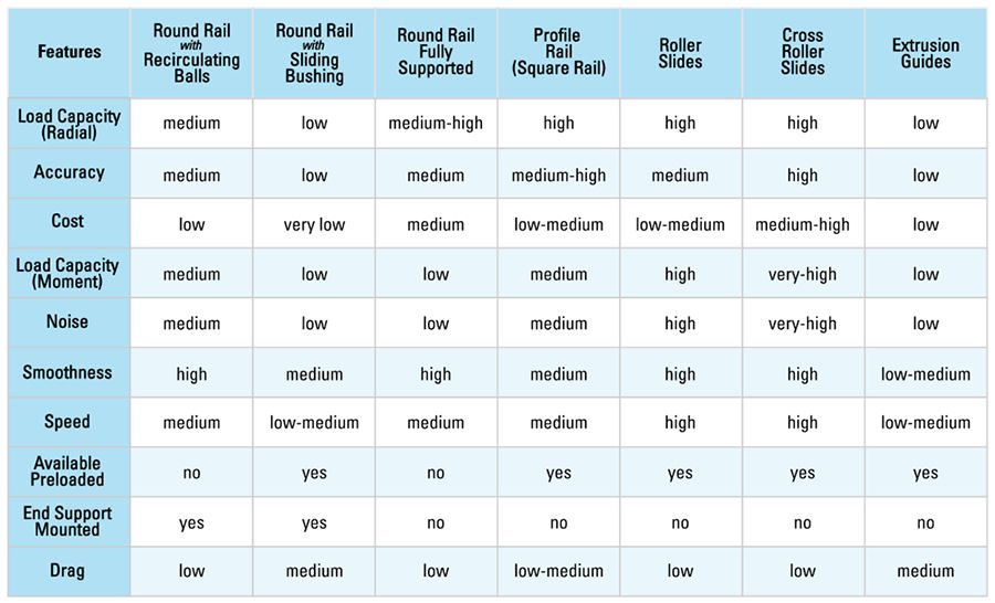

Figure 5: Helix Linear guide system with dual profile rail guides.

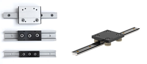

Roller slides provide a very economical means for linear system guidance, generally constructed of lightweight aluminum with four rollers inside the carriage that run on hardened shafts. Roller Slides are suitable in applications requiring high speeds with large on-axis loads and moment loads. In addition to providing a stable and accurate means for linear motion and a low design profile, they are also a low-noise solution vs. their recirculating ball counterparts.
Figure 6: Helix Linear Technologies roller slide linear guide systems.
