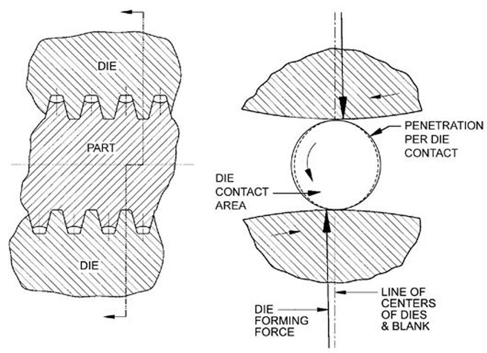

Cylindrical die thread and form rolling is a metal forming process whereby helical, axial, and annular profiles such as threads, worms, splines, and grooves are formed in the surface of a cylindrical blank by the phased interaction of two or three round dies. The dies are forced into the periphery of the blank while rotating it at nearly the same surface velocity to displace the blank material radially into the form of the die until the final geometry is achieved. Dwell is used to round-up and calibrate the final form before disengaging the dies. It is a constant volume process whereby material is neither added nor removed.pt1223_Page_41_Image_0001.jpg
Figure 2—Infeed thread rolling process.

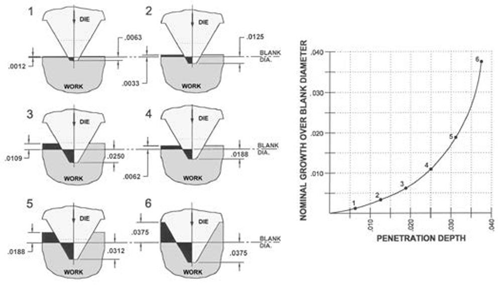

Figure 3—Volumetric material displacement during die penetration.

Infeed is used to roll discrete lengths of thread within the width of the die face using a single plunge and retract operation. Two or three dies are positioned on parallel axes with the blank, and there is little to no axial feed of the part during the forming operation. Infeed rolling can produce complete forms in two to three seconds or less. The forming operation itself is generally much faster than the time it takes to transfer the part in and out of the dies. Automated infeed thread rolling systems with mechanized feeders can achieve production rates of 15 to 60 parts per minute depending on the part configuration and forming cycle.

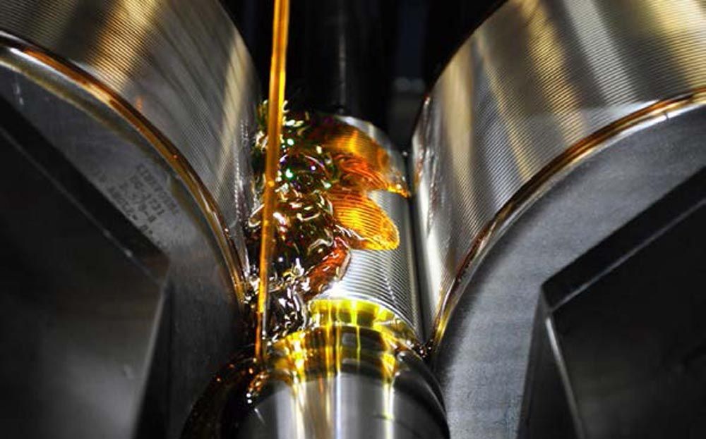

Throughfeed is used to roll continuous lengths of thread using relatively narrow dies tilted on opposite skewed axes. The blank rotates and feeds through two or three dies at fixed center distance while the form is progressively generated as it travels through the dies. Throughfeed rolling of long forms having lengths of four meters (12 feet) or more can produce rolled product at rates of 30 to 60 inches per minute or more depending on the capability of the thread rolling machine and design of the dies. Forms that are rolled in long lengths can be colletted in a screw machine and cut into shorter pieces for subsequent machining or finishing operations.
pt1223_Page_42_Image_0001.jpgFigure 5—Throughfeed lead screw rolling.
In a cutting operation you’re limited by the power of the machine tool, the length-to-diameter ratio of the part with respect to form depth, and the ability to remove heat at the cutting insert. In a cold rolling operation, you’re limited by the power of the rolling machine and the ability to transfer the electro-mechanical energy into forming the threads without slipping or stalling the blank. The unbalanced cutting forces of a single-point cutting operation can severely limit the length of form to be cut based on the length-to-diameter ratio and form depth. Rolling has balanced forces around the part which essentially allows you to produce unlimited lengths if the parts can be sufficiently supported.

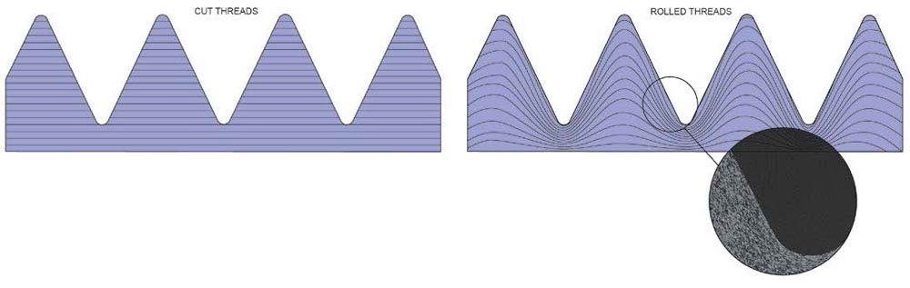

Strain hardening that occurs due to cold working of the material is another mechanism to be considered with respect to overall strength. Alloy steels and stainless steels which work-harden when cold worked, can strain-harden as much as 5 to 8 HRC points or more during the rolling operation. It is not uncommon for a rolled thread to be in the vicinity of 10 to 20 percent stronger than a cut thread of the same size in a given material. A cutting process removes portions of the existing material structure and does not yield beneficial residual stresses in the form. It can also leave sharp transitions whereas rolling leaves radius transitions which minimize stress risers.
pt1223_Page_43_Image_0001.jpgFigure 9—Cut thread grain flow vs. roll thread grain flow.
Rolling can also be carried out in heat-treated materials which can result in additional fatigue resistance. This can be a showstopper for cutting processes where machine stiffness and cutting edges don’t hold up. However, high hardness blanks significantly reduce the tool life of a thread rolling die and significantly increase forming loads. Rolling is regularly carried out on pre-roll blanks with hardness of up to 36 HRC, and higher. Above this level of hardness, the tool life is significantly reduced. Some high-strength threaded studs, bolts, and actuator screws require rolling to be performed on blanks up to and exceeding 46 HRC.

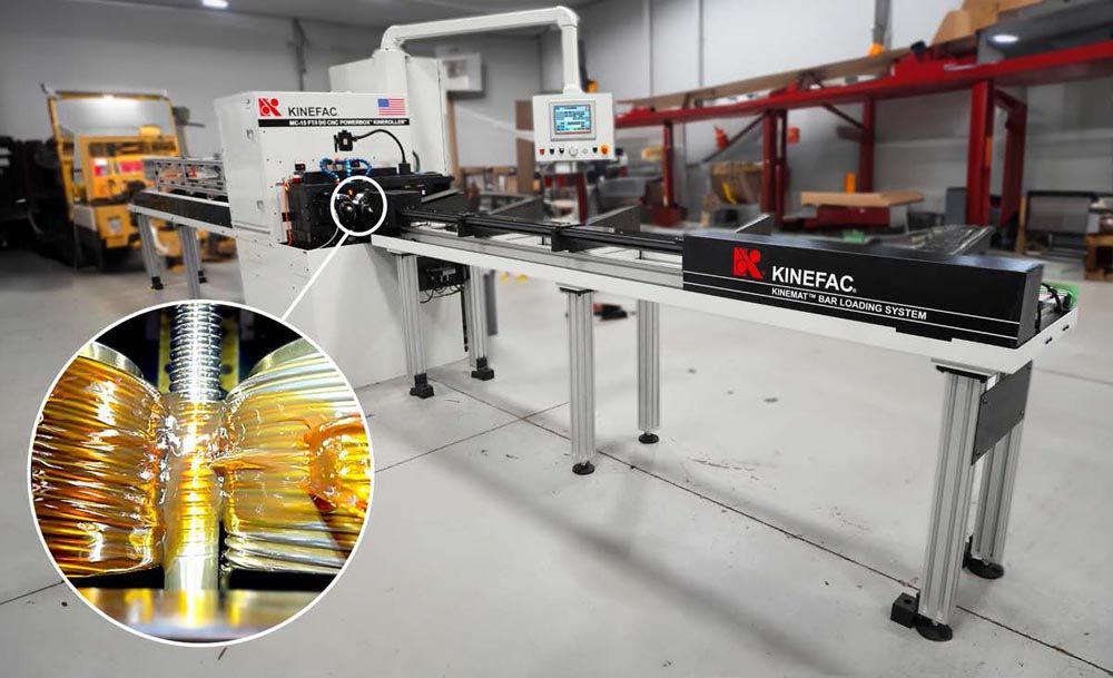

pt1223_Page_44_Image_0001.jpgFigure 10—Kinefac MC-15 CNC KineRoller with bar feed unit.
Thermal characteristics of the throughfeed process also contribute to the amount of die lead compensation. The energy required to roll is transferred into the part and comes out as heat. Part shrinkage due to cooling to room temperature can also result in a lead which is shorter than the dies.
Spring-back compensation for lead accuracy is generally determined by testing due to the multitude of variables involved. Once determined, it will remain constant and repeatable assuming good consistency of the blanks. Precision CNC rolling equipment and throughfeed dies with good blanks and thermal stabilization of the rolling lubrication and dies can produce ball screw, trapezoidal screw, and ACME screw lead accuracy of .025 to .050 mm per 300 mm (.001 in. to .002 in. per ft.) rolled length. Meeting a tolerance of .100 mm to .150 mm per 300 mm (.004 in. to .006 in. per ft.) is standard. A good thread cutting or grinding machine with an accurate lead screw and high stiffness slides can also achieve precision lead tolerances.

Thread and form rolling is a constant volume process, meaning material is neither added nor removed. Therefore, the volume of the pre-roll blank is the same volume as the final rolled part. The pre-roll blank diameter is smaller than the major diameter of the rolled form and is usually close to the pitch diameter. This is because material is displaced radially from the blank into the die form during penetration. The angled flanks of the die thread form provide a wedge-action to raise the material above the blank surface as the dies are penetrating. A cut thread must start out with a blank which is at least at the major diameter because material is removed to leave the desired form. A calculation by volume can demonstrate a potential material savings of close to 20% or more when using the rolling process.
Example: Throughfeed Rolling 1-1/4"-5 TPI ACME Lead Screw
Pre-Cutting Blank Diameter ~1.250-in. (31.75 mm)
Pre-Roll Blank Diameter ~1.132-in. (28.75 mm)

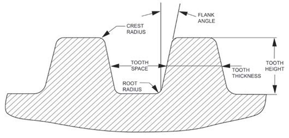

Thread form geometry also influences the performance of the rolling process and tool life. Rolled forms are ideally designed with sufficient corner radii to help promote material flow and reduce stress risers. Flank angles and pressure angles are ideally kept above a low of 10° to 12° and lead angles are ideally kept under 30°. Form depths should be kept under 25% of the part major diameter, and tooth thickness versus tooth space should be as balanced as possible.
pt1223_Page_45_Image_0002.jpgFigure 12—Form profile geometry.
