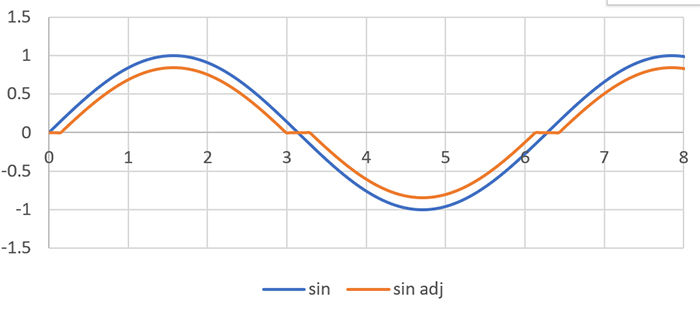

Looking at a series of the specifications provided by multiple step motor manufacturers — and not all provide accuracy specifications — the specifications are called out as ±3% to ±6% non-cumulative error by different vendors; others call out a step to step error of .09 degrees for a 1.8 degree step motor (±5% of a step). This is the best expected open loop accuracy for the no-load condition at the full step location, which hides the effect of detent torque. Thus even with perfect microstepping current control, the expected error from the unloaded motor is not better than 1/20th of a step. And real position error only gets worse as we start adding any load and friction to the motor!
Figure 1 Deadband
Figure 2 Dead-band Error in degrees
Figure 3 Gated Anti-Phase
Figure 4 Norm Torque vs. Error steps

The motor manufactures typically specify resistance as ±10% at room temperature, with inductance typically specified to ±20%. A good current mode driver should compensate for most of these differences, at least for the full step locations. Many recirculating drives have problems controlling the current near zero current due to cross over distortion. Two issues that contribute to this error: dead-band and minimum duty cycle. Dead-band arises from the minimum allowed time between turning off the upper transistor stage and turning on the lower stage (or Vise-versa) that is allowed so as to prevent shoot-through current (current which flows through both high-side and low-side transistors — which generates much EMI and can destroy the driver). On a PWM controlled stage, the dead-band reduces the effective PWM signal so that the overall current is reduced towards zero. This reduces both the peak expected current (which can be easily corrected with a PI current controller) and the current near the cross over (which is not as easily corrected if the commutation rate is faster than the PI loop). The dead-band shown corresponds to 200nS of dead time with a 25kHz chopping rate for a 2.5v motor running from a 48v supply. This level of error represents 0.16 degrees or about 1/8 of a step (Figure 2). QuickSilver compensates for dead-band, which significantly reduces the position offset when operating in open loop, and smooths the resulting motion when operating in closed loop.
Another significant distortion inducing limitation is the minimum allowable on-time for the driver. The transistors take a finite time to fully turn on before they are switched off again. The minimum on-time can be on the order of 1uS for some common drivers. For a 25kHz chopping rate (40uS per cycle), this is 2.5% on minimum. With a 48v power supply used with a 4 amp 23 frame motor — typically having a .5 ohm winding resistance, the minimum on time produces 1us/40us*48v = 1.4v to the winding. With a .5 ohm winding this corresponds to 2.8A. To reduce the current to a lower level, the chopper drive must either drop out of recirculate mode (which makes the average current much less than the peak sensing used in the control loop and increases the ripple current), or it must increase the time between pulses which allows the chopping frequency to enter the audible frequency range causing an audible squeal. The large minimum current also causes a significant step in position as the current reverses as the current jumps from the minimum positive current to the minimum negative current when using a typical current sensing recirculate scheme. QuickSilver addresses this by using a gated anti-phase technique in which a controlled reverse pulse period is used with the main forward pulse to allow a smooth transition from positive to negative current while keeping the motor drive active (avoiding decay mode and its large ripple currents). The gated anti-phase technique also allows for excellent control of the current in all four quadrants of operation — that is both when using the motor to accelerate the load (supplying power — 1st and 3rd quadrant) and when using the motor to decelerate the load (absorbing power — 2nd and 4th quadrant). Typical peak current sensing recirculating drivers are not as accurate in the 2nd and 4th quadrants controlling the current while decelerating the motor.
