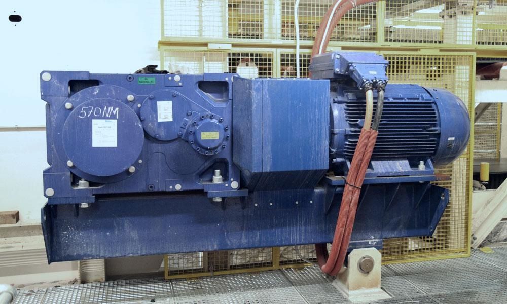

MAXXDRIVE XD industrial gear units are NORD’s newest product lineup designed specifically for cranes and hoists. Compared to standard MAXXDRIVE housings, the XD series has center distances that have been increased by 35 percent, enabling a U-shaped drive arrangement with the cable drum and motor on the same side of the gearbox. The housings are also optimized for downwards forces and include an inspection cover for quick, easy maintenance.
For applications with particularly high thermal ratings, MAXXDRIVE XT industrial gear units are available. These right-angle units feature an optimized ribbed housing for greater heat dissipation and airflow as well as effective fan cooling due to an enhanced axial fan and air guide cover design. MAXXDRIVE XT units also offer a symmetrical design for mirror image installations where space is limited and can be equipped with a swing base depending on the application.
The MAXXDRIVE standard line of industrial gear units are extremely versatile and are engineered to handle the toughest loads with output torques up to 2,495,900 lb-in. and power up to 8,075 hp. They are built from high-strength, one-piece UNICASETM housings that enclose all internal components to protect operators from pinch points, reduce maintenance, and extend service life. As different bulk goods require varying plant arrangements, MAXXDRIVE gear units are adaptable to accommodate input and output shafts according to specific dimensions, multiple installation positions, various output shaft bearings, and a wide range of output flange and motor options.
90.1 helical bevel gear units are commonly used for bulk goods conveyor applications due to their high efficiency, reliability, and high radial and axial load capacities. They are built from robust, cast iron UNICASE housings and feature infinite life gearing, minimum backlash, and various shaft, mounting, and bearing options, making them highly adaptable to precise application requirements. These gear boxes are available in 11 case sizes, provide torque up to 442,500 lb-in, and performance up to 268 hp.
CLINCHER parallel shaft gear units provide reliable, efficient operation in a cost-effective, compact design. The robust cast iron housings are machined in a single process and require very low maintenance while delivering quiet operation and a long service life. CLINCHERs supply up to 268 hp, produce up to 885,075 lb-in of torque, and have 15 case sizes with flexible mounting options to choose from, making them highly adaptable to fit precise application requirements.
