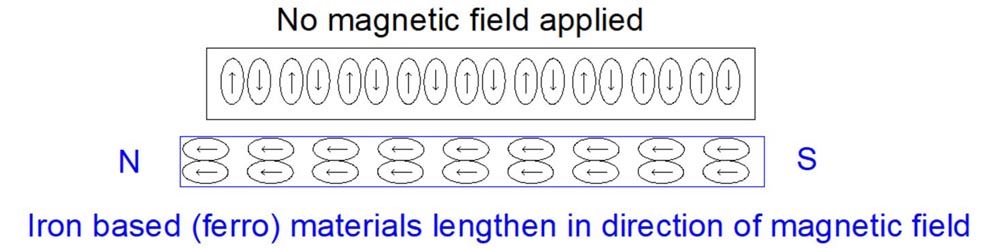

Most motors include iron or other magnetic materials (ferromagnetic) in either their rotor or stator or both. Many magnetic materials have magnetostriction properties, meaning that they change their shape or dimensions as a function of the magnitude of the applied magnetic field. The effect arises at the microscopic as the boundaries of and magnetic vector within domains are varied in response to the applied field. The domains try to align with the applied field so as to minimize the free energy of the system. The hum of a common transformer is mostly caused by magnetostriction. The commutation process of a motor involves causing the magnetic fields to vary to cause a torque to be generated between the rotor and the stator, leading to the rotor turning. These changing fields also give rise to changing dimensions, which can cause surfaces of the motor to act as speakers.

Figure 1 Magnetostriction
Ferromagnetic materials will have their domains align with the magnetic field, causing the physical dimension of the material to expand in the direction of the magnetic field. Some other materials, such as cobalt, contract in the direction of the magnetic field due to different crystal lattice structures.

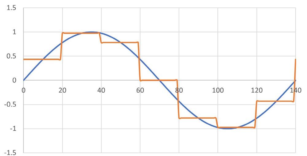

Figure 2 Commutation Smoothness
Driving the current as fast as possible for the next requested current causes an abrupt change in torque resulting in jerk in the system as compared to a smooth change in current.

In the hybrid motor realm, there are microstep drives which more closely approximate a sine wave by adding many finer steps to the current waveform to reduce the magnitude of each step change. However, most of the drivers use a current control loop that still tries to achieve the next step in the minimum time possible, turning the driver full on until the next desired current plateau is attained. The conventional 3-phase brushless motors are similar with sinusoidal commutation. Note that the design of the motors for trapezoidal 3-phase operation are different than those for sinusoidal commutation, the former having back-EMF waveforms that are typically much squarer than the sinusoidal back-EMF waveforms associated with sinusoidal drive optimized motors. Hybrid motors, similarly, are optimized for either full stepping (50:50 laminates) or for microstepping (48:50 laminates or 50:52 laminates for the common 1.8-degree stepper). When plotting the back-EMF of phase A versus phase B, a full step (50:50 laminate) will plot as almost a square with slightly rounded corners, while a microstep optimized motor will plot as almost a perfect circle.
The noise level generated by a motor may be minimized by minimizing the rate of change of the current in the winding, making it a function of the motor speed, rather than having the current loop attempt to perfectly follow the square change with each new step on the microstep table. This may be done by altering the operation of the current control loop to also utilize a motor speed estimation such that at lower speeds, a lower rate of change is implemented, and saving the rapid changes for higher speeds where motor torque would suffer if the current were not changed at a sufficient rate.
