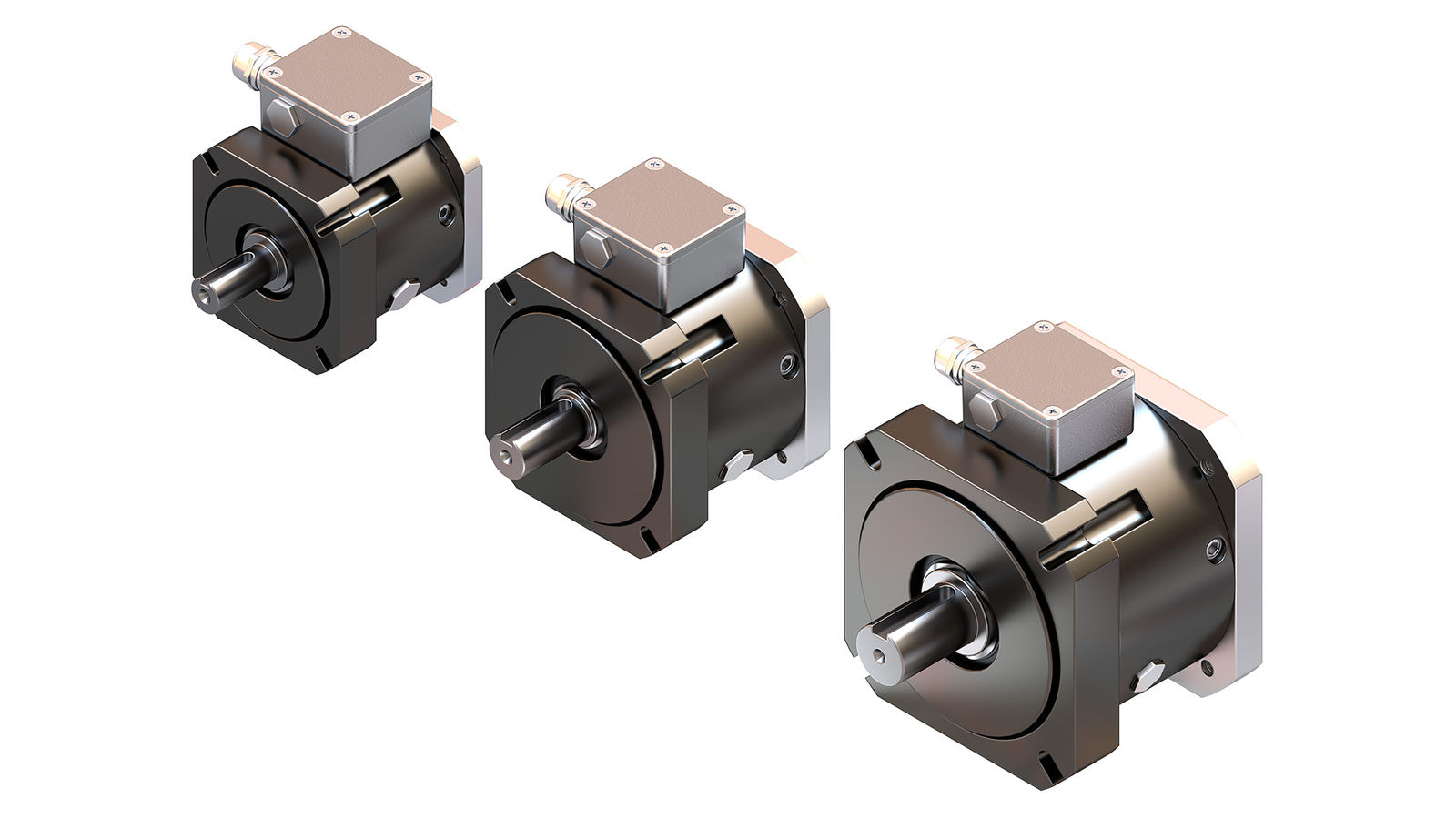

The Evolve Electric Servomotor Brake line is spring engaged and electrically released, engineered with a double-sided friction interface for increased torque capacity. The double row angular contact bearing delivers overhung load capacity and rigidity allowing machine builders and OEMs to design a more robust machine. The brakes can easily be configured to match the motor and gearhead mating interfaces.
Manufactured in Webster, WI., the Evolve Electric Servomotor Brake has fast delivery times, allowing for minimal downtime in designing and maintaining machines.
“The application challenge required a zero-backlash stand-alone product that could be incorporated into an existing system. The Evolve line was engineered and sized to fit with most manufacturers’ standard motor offerings. The Evolve servomotor brake can be incorporated into a system using the existing servomotor and gear reducer with minimal effort,” Zollner said.
The Evolve series of servomotor brakes is set to be leading-edge brake solution offering high-end rigidity, torque, and zero backlash in a very simple-to-install and reliable package. Fewer parts equal a much more reliable product that machine builders and maintenance staff can rely on.
“Robotics, machine tools, assembly, and packaging will be the biggest users of the Evolve servomotor brake. However, any axis that is driven by a servomotor is an excellent candidate for benefiting from the new Evolve servomotor brake,” Zollner added.
Nexen’s Evolve Electric Servomotor Brake Specifications
  • 100 mm, 125 mm and 155 mm frame sizes available
  • Easily mounts between a servo/stepper motor and a gearbox
  • Spring engaged – electrically released
  • Two friction interfaces for increased torque
  • Zero Backlash via flex disc and rotor
  • Double Row Angular Contact Bearing
  • Shaft with integrated clamp collar
  • 24 VDC standard coil
  • Fast delivery times
  • Made in the USA
