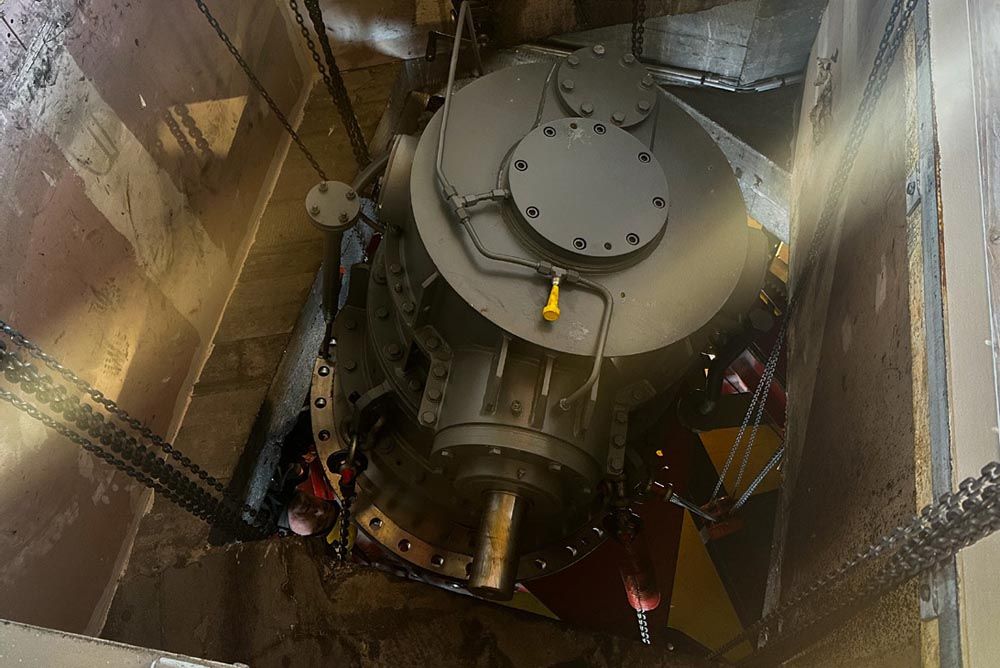

Image2.jpgMaintaining and replacing planetary gearboxes on a ski lift in Europe comes with a unique set of challenges.

Gearbox installation for any application has its own unique set of challenges, but how about handling equipment of this size and scope on a mountain?
“Some of the challenges involved with the job were first, the altitude at which the job had to be performed and the gearbox installed,” said Ravache. “Indeed, the design of the lift was made so all three gearboxes would operate from the middle section—thus at 2,317 m altitude. For security reasons, the lift was designed so that one gearbox would drive the first stage and one for the second with a back-up right beside it.”

Another challenge was the time given to swap gearboxes.
“Keep in mind that the summit is very popular and attracts tourist year long. Thus, giving little time for maintenance services. The service team was given only three days to do their job before inspection and testing was conducted by a third party,” said Victor Manoury, sales engineer at FCMD North America, representing CMD Gears in North America.
“The last challenge goes without saying,” said Ravache. “The new gearbox has a zero-failure allowance. Having people stuck in the middle of the lift would be a disaster.”

While maintenance operations have been done directly on site over the last couple of years, now that the Mount Blanc Company has a spare part this permits greater flexibility. “This allows them to send back their reducer to our workshop in Cambrai, France and have us perform our usual gearbox inspection by fully inspecting each component inside,” Ravache said.
The field engineers’ experience in areas like cement and mining—where installations and maintenance take place in both extremely hot and cold environments—helped the team prepare for the ski lift upgrade.
“Our field servicing team is quite used to working in these types of conditions,” Manoury said. “Field servicing is one of the three solutions we provide to our clients. We have vast experience in gearbox manufacturing, on-site services, and repairs.”
