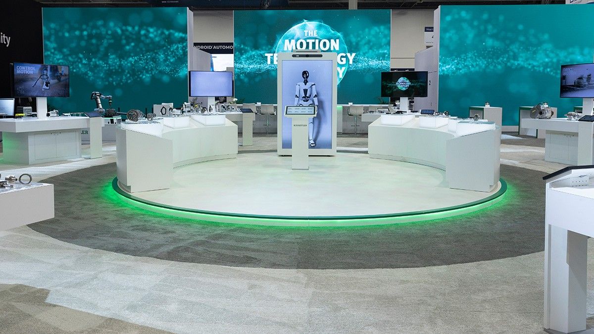

First, please tell us what the response was like at CES 2025 to Schaeffler’s Humanoid Technology Exhibit?
It was good. The interactive humanoid “hologram” was an eye catcher. Several different people in the humanoid sector stopped by whether it was competitors, investors, suppliers, potential customers. The show was really effective. We must answer the question frequently, “Is Schaeffler making their own humanoids?” And the resounding answer is, no, right? We do want to showcase what we can achieve as a supplier to humanoid OEMs, however. Industry observers noted the exhibit’s emphasis on Schaeffler’s expanded motion product portfolio, a development bolstered by the company’s recent merger with Vitesco Technologies. This strategic move has enhanced Schaeffler’s manufacturing and research capabilities, positioning it as a comprehensive provider of motion solutions across various sectors. Overall, the response was positive, with attendees and industry experts recognizing the company’s innovative approach to motion technology and its impact on the future of robotics.

Schaeffler’s Humanoid Technology Exhibit was a booth highlight at CES 2025 in Las Vegas.

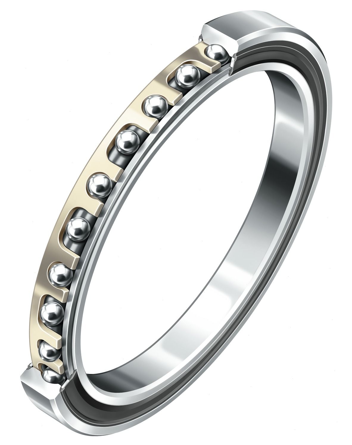

What role do bearings play in these applications, and why is a customizable approach so critical?
Lightweight, high torque density, and low friction will continue to be important for smooth humanoid control and battery life management. Customized bearings might be necessary in certain actuators and certain positions, but it’s wise to pursue standardized solutions where possible especially when we talk about mass production in the coming years.
Part of Schaeffler’s “Guide Motion” family of products and solutions: thin section bearings.

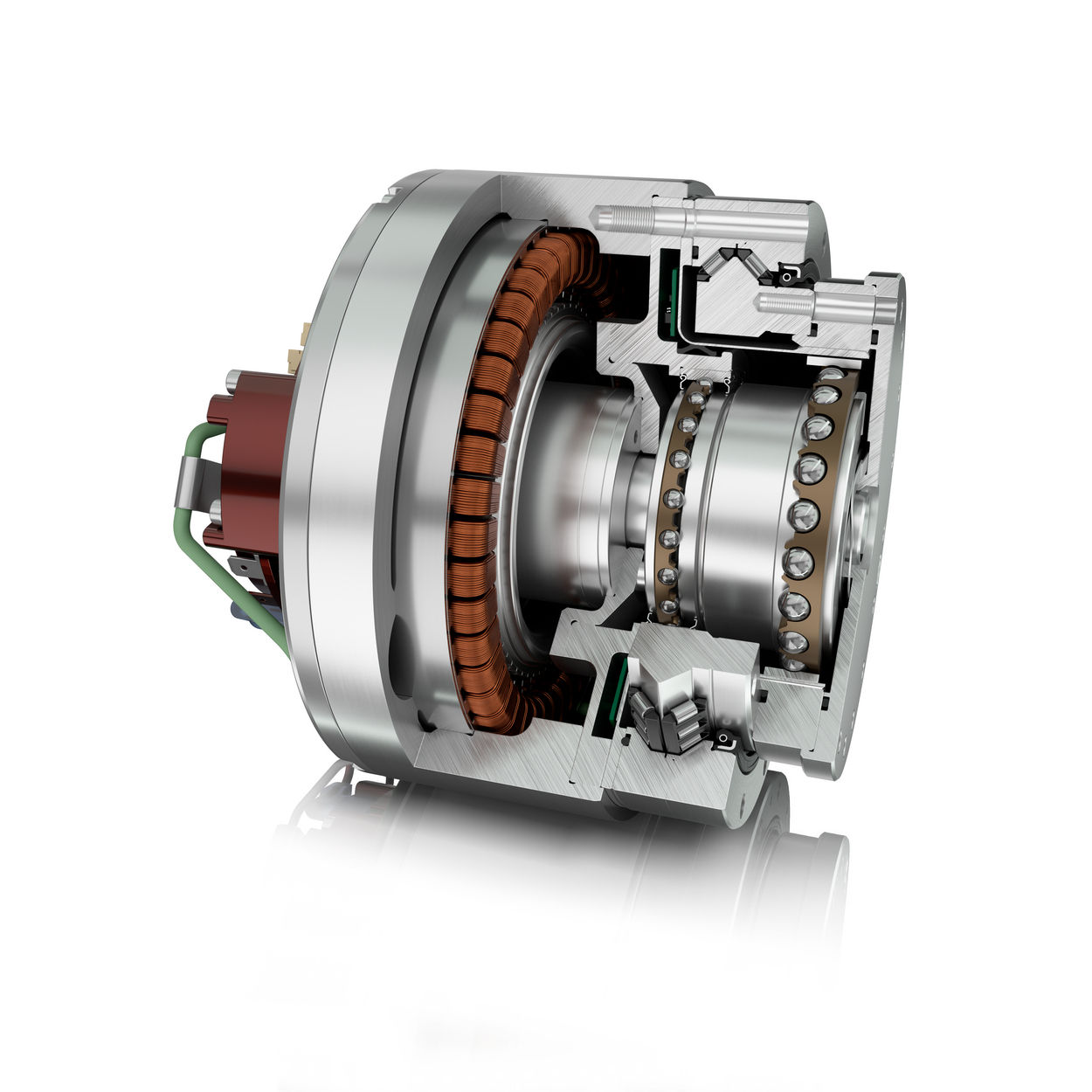

Why is Schaeffler’s system design approach so important moving forward?
Based on the automotive suspension parallel, I would extend your question to include automotive and e-Mobility applications. I think we have the tools and business processes to pull ideas from various parts of our business to develop holistic solutions and not just component solutions. We’ve seen such successes in a short period of time with transforming current sensor technologies from ex-Vitesco into relevant force sensors for humanoid actuators, and we have many similar irons in the fire right now. I think our humanoid display at CES is going to evolve significantly over the next couple of years.
Part of Schaeffler’s “Generate Motion” family of products and solutions: rotary actuator.

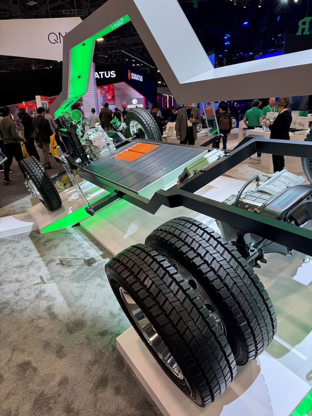

The merger with Vitesco Technologies, completed on October 1, 2024, expands Schaeffler’s presence globally, adding new manufacturing plants and boosting the company’s research and development capabilities. Schaeffler’s solutions now cover the entire spectrum of motion, from power transmission to energy generation and sustainability, allowing for a seamless integration of technologies. Especially in the field of electromobility, Schaeffler can now offer customers a comprehensive product range and can therefore derive even greater benefit from the growth potential in the electromobility market.
Schaeffler’s Dynamic Performance Vehicle at CES 2025 highlighted the full range of technologies for chassis systems and electrified powertrains, augmented by the addition of Vitesco Technologies. The company can now deliver a battery electric vehicle solution, featuring all vital components and systems required for a complete electrified powertrain. The interactive exhibit demonstrated these solutions–from components and systems for light passenger cars to heavy-duty applications.
