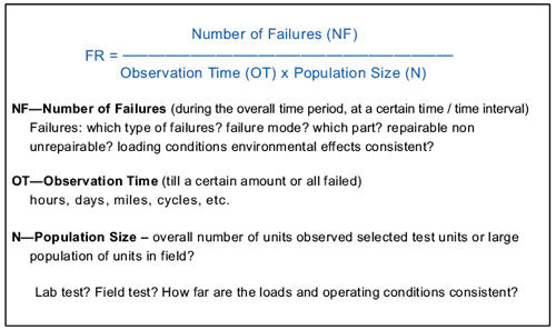

Is Apple correct with the 5% value over the design life, or are the conclusions of the survey with 13.7% correct?
Here are some important questions before we take sides: Are both talking about the same type of failures? Does Apple consider the necessity to replace the battery a failure? How many units were surveyed by Apple? Is the population of 9,000 samples in the survey representative? (Apple ships in excess of 10 million units a quarter.) What was the real usage time or reference time of both observations? Does the statement “built to last four years” mean four years at 24/7 usage, or, for instance, only four hours a day, six days a week.
None of the above two failure rates gives any specific information about these important basis factors, nor about the conditions under which the data were collected. Let us assume that the survey was based on a 12-hour daily usage over a two-year period; the failure rate should be calculated as:
Equation 1
The example above highlights the main difficulty of the reliability/life calculation and the main source for misrepresentations, namely, the selection of the population, the observed time interval and failure mode, etc.
