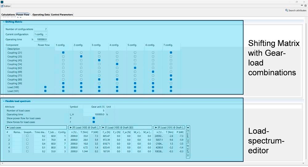

With the current version of the FVA-Workbench, this feature has been expanded to include “flexible load spectra.” This makes it possible to create any combination of loads and switched gears with the associated time percentages in an intuitive editor (see Figure 1).
This article appeared in the April 2024 issue.
Figure 1—Shifting matrix with gear-loaded combinations and load collective editor.
A separate system calculation is performed for each of these load cases, followed by an additional accumulation of the load cases and their respective time percentages. This means that the user can subsequently evaluate the effects of the various operating states separately as well as the result of the entire calculation in FVA-Workbench reports.

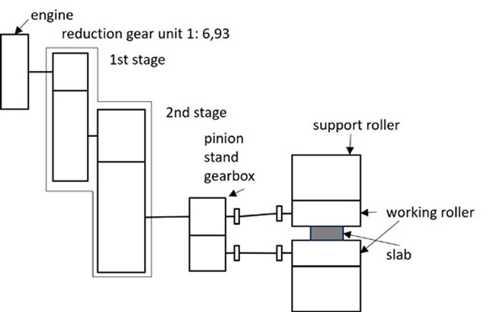

Example Application: Rolling Mill Gearbox
The benefits can already be observed in the simple drivetrain of a rolling mill, the schematic of which is shown in Figure 2. The key data for the design originates from the FVA 131 research project.
Figure 2—Drivetrain of a rolling mill.

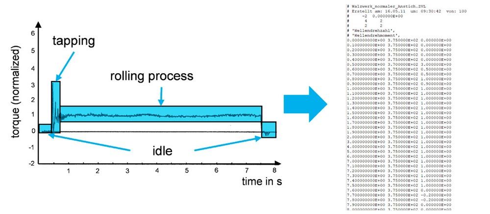

Two important phenomena can occur during the rolling process: normal tapping or tapping with so-called chatter vibrations (see FVA 131). Here, we are only concerned with normal tapping; however, the process for consideration of chatter vibrations is similar. In greatly simplified terms, normal tapping consists of three operating states which are repeated every eight seconds:
  • Start of tapping
  • Rolling process
  • Idle
Figure 3 shows the profile of the normalized torque over time.
Figure 3—Profile of the normalized torque.

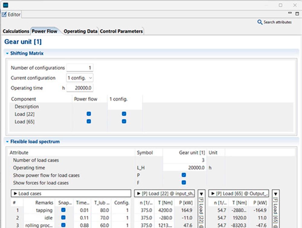

With the FVA-Workbench, these single-parameter as well as multi-parameter (i.e., with additional consideration of speed, external forces, etc.) time histories can easily be converted into load spectra for the system calculation. Figure 4 shows the prepared load spectrum for normal tapping in the flexible load spectrum editor.
Figure 4—Flexible Load Collective Editor.
In the next step, the calculations can be performed using the specified load spectrum.

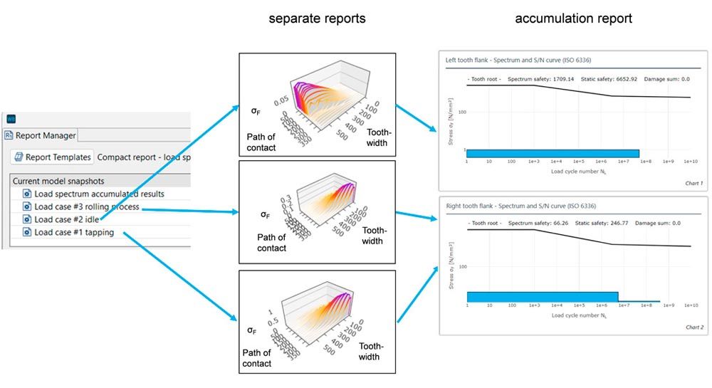

In principle, the results are output in a similar manner to scaled load spectra (powertransmission.com/blogs/1-revo-lutions/post/9006-fva-presents-transmission-design-considerations). The key difference, however, is that individual reports are also available for each load case in addition to the report for all accumulated load cases (see Figure 5).
Figure 5—Individual reports and accumulated reports in the result output.
