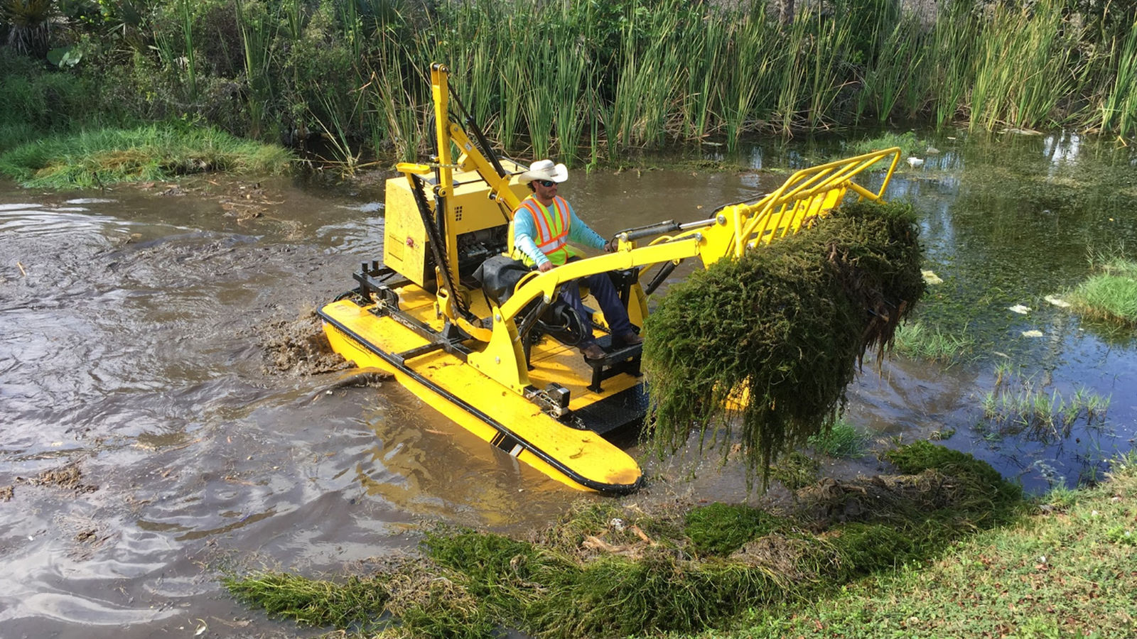

Mechanical removal of weeds and debris avoids the use of threatening substances, but working in the water with hydraulic equipment poses a new set of challenges. These machines require essential fluids for transmitting power, lubricating the system, and dissipating heat. While there are many options available, most are not suitable for use in water. Mineral-based options are not biodegradable, cause long term pollution, and are toxic to aquatic life, so even a small leak, much less a blown hydraulic hose, can have disastrous effects on the environment. Plus, there are potentially high fines for these accidental discharges. Water-based fluids are a logical consideration, but they are only moderately biodegradable, must be replaced frequently, and they tend to wash away. They’re also better for low pressure systems and places that are not environmentally sensitive. To make matters even more complicated, regulations for chemical use in waterways become more stringent every year. In 2024, the Environmental Protection Agency (EPA) introduced the toughest clean water legislation so far, with stiff penalties for violators.
Weedoo realized that an environmentally friendly hydraulic fluid was in order. While researching the options, they found that not all eco-conscious choices are the same. Even though they are the same ISO weight, there are significant differences in oxidation process, resulting in critical variances in performance. Oxidation is a complex series of chain reactions common to most hydraulic fluids and consists of three stages: initiation, propagation, and termination. During the initiation phase, hydrocarbon molecules react with various catalysts, such as heat, pressure, or contaminants, which leads to the formation of free radicals (highly reactive molecules that combine to create new products). In propagation, the radicals keep the process going by reacting with oxygen, creating peroxides and other reactive species. Sometimes the byproducts from these reactions also act as propagators, speeding up the process even more. Many factors including high temperatures, moisture, metal contaminants, and agitation can also accelerate the oxidation process, leading to very rapid degradation. Consequences of oxidation include increased oil viscosity and organic acids; the formation of sludge, varnish and deposits; additive depletion (including anti-wear additives, dispersants, and corrosion inhibitors) and the loss of other vital performance properties. The termination phase occurs when stable, nonreactive products have formed, and oxidation has ended.

As Bobby O’Shields from Weedoo noted, “We use BioFleet ISO 46 in our machinery. The fact that it is 100 percent biodegradable makes it favorable for use with our Weedoo Boats, as we are running our equipment in fragile ecosystems.”
