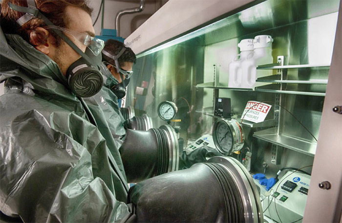

Freudenberg Sealing Technologies has expanded its material testing capabilities to include performance and compatibility evaluations of the rubber, elastomers and thermoplastics used to seal and safely maintain lithium-ion batteries. The company has installed sophisticated equipment and adopted new testing protocols in its Plymouth, Mich., Central Laboratory that will provide conclusive data on which materials optimally resist breakdown from constant exposure to harsh electrolytic solutions. Such data has not been readily available in the private sector until now.
The centerpiece of the six-figure investment is a specially designed Isolation and Containment Chamber (IsoC) that allows technicians to safely conduct exposure testing using the aggressive lithium electrolytic solutions found in lithium-ion battery cells. These solutions are volatile, toxic, and flammable when exposed to oxygen and ambient air moisture. The IsoC, a six-by-three-by-three-foot, two-chambered glass, and steel enclosure, allows chemists to work in a controlled, inert, and moisture-free environment.
In addition, Freudenberg Sealing Technologies also invested in a sophisticated telemetry control system that facilitates remote IsoC monitoring of the active work 24/7, head-to-toe protective gear and special respirators for chemists, non-reactive, nickel-based immersion vessels, a safety monitoring and alarm system and electrolytic solutions costing thousands of dollars per gallon.

“All of our exposure testing must be performed inside the IsoC in an oxygen-free, moisture-free environment,” said Freudenberg Sealing Technologies’ Michael Saruna, the Central Laboratory chemist who is in charge of material testing in electrolytic solutions. “Electrolytic solution exposed to air can result in a hazardous situation, so we had to take safety and our ability to maintain a controlled environment into account during the design of the IsoC.”
The dual chambers of the IsoC allow Saruna to install test samples in the first chamber, purge all air, oxygen and moisture from that space and then move them to the second, larger IsoC chamber for exposure testing. Materials will be immersed electrolytic solution for at least 1,000 hours, then decontaminated to insure they are safe for removal from the IsoC. They will then be subjected to the company’s standard physical and analytical test methodologies.
