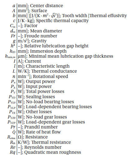

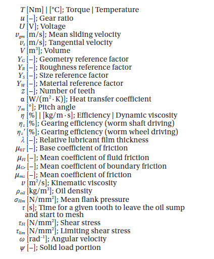

Abbrevations

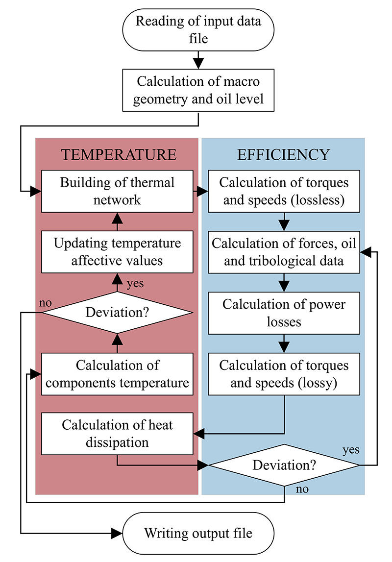

Figure 2: Flowchart of efficiency and heat balance simulation.
Since temperature influences oil viscosity, which greatly affects the power loss of a gearbox, a temperature calculation model is required for an automatic and precise efficiency calculation. Since a gearbox shows local differences in temperature, it is reasonable to not only calculate a mean temperature for the whole gearbox but also specific local temperatures of the single components. This local heat balance analysis not only provides an opportunity to predict the thermal load capacity, but also to detect hot spots inside a gearbox. Using a TNM makes it possible to determine component temperatures in gearbox systems.

Implementation in Simulation Program
The efficiency and temperature calculation described in Sects. 3 and 4 appropriate to gearboxes with worm gears is customized and implemented in the simulation program WTplus (Ref. 16), which is currently applicable to gearbox systems containing cylindrical and bevel gears. WTplus uses routines for the calculation of the efficiency and heat balance (Fig. 2). Initially, a routine reads the input data followed by the macro geometry and parameter calculation according to (Refs. 7–8). Where necessary, data is automatically complemented. WTplus then calculates the efficiency (blue) and heat balance (red) iteratively. If the calculation results in enough exactitude, an output file containing all relevant data is generated. The efficiency and temperature calculation, as well as the required extensions for gearboxes with worm gears, are described in the following Sections.
Efficiency calculation. The simulation program calculates all torques and speeds, including a power flow analysis, according to Stangl (Ref. 37). Initially, these torques and speeds are not affected by any losses (loss-less) but are only dependent on the kinematics of the gearing system.
Next, with the torques and speeds known, forces caused by the tooth system of worm gears can be calculated according to DIN 3996:2019-09 (Ref. 9). Subsequently, the tooth system forces are put into shaft-bearing context and thus the simulation program determines the reactive bearing forces. Then, oil data as viscosity and density is calculated to determine the tribological factors (see previous sections). Considering these values, the specific power loss portions of gears, bearings and seals are computed (see previous sections).
Lastly, the simulation program calculates all torques and speeds again, but this time it takes into consideration power losses that reduce the torques (lossy). Since these reduced torques change the tooth system forces, this leads to different bearing forces and thus changed power losses. Therefore, an iterative solution must be considered, comparing the output torques of two subsequent iterations. If the deviation between those results is below a given limit, efficiency is considered solved and the temperature calculation begins.
Local temperature calculation. The simulation program is not only able to solve the oil temperature, but can also solve local temperatures of single components fully automatically, based on the TNM explained previously.
It is notable that the thermal network is built up fully automatically, abstracting the gearbox by suitable nodalization, linking those nodes and calculating necessary thermal conductance. The following explains the process of the abstraction for worm gears and shows solutions for the calculation of thermal conductance.

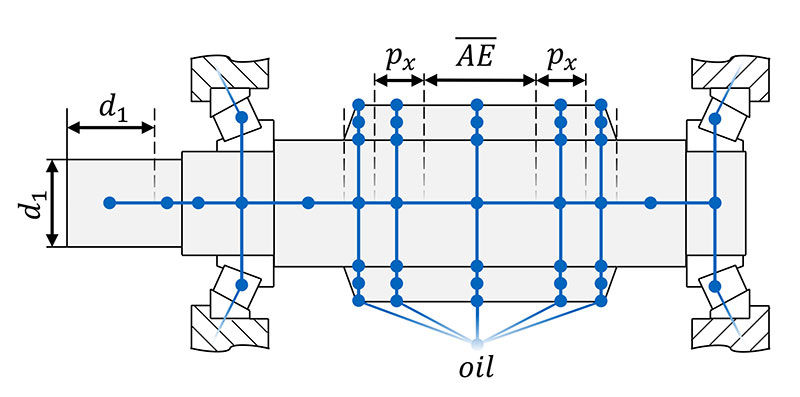

Nodalization. The gearbox with its gears, shafts, bearings, housing and oil is considered a system, which is nodalized. The housing is considered an isothermal body, and thus abstracted by a single node. It is linked to the environment, oil and bearings. The environment acts as a boundary condition in the form of a heat sink with a specified temperature. The oil sump is assumed to be isothermal and thus is abstracted by a single node — like the housing. Hence, the effect of temperature differences due to oil flow is neglected. Funck (Ref. 10) investigated the heat balance of gearboxes and derived formulae to describe the thermal behavior of the gearbox housing and oil sump.
Schleich (Ref. 33) investigated the thermal behavior of bearings using a thermal network. Due to uncertainties and several assumptions, he concludes that dividing bearings into their components represented by a thermal network is challenging. Therefore, bearings are simplified and a single node assuming a mean temperature of the bearing is used.
Regarding shafts, Geiger (Ref. 11) shows the need to divide long narrow bodies suitably into several isothermal sections in order to minimize calculation errors and preserve compact network size. In terms of axial distance, the width of an isothermal section is set accordingly, as less than or equal to its shaft diameter. Furthermore, the simulation program generates a new isothermal section wherever a component (bearing or gear) or a diameter change of the shaft is located (Fig. 3).
Regarding the gears, it is reasonable to subdivide them into the gear body, teeth and tooth flanks. Two-piece worm wheels, as are often used, can be considered by abstracting the wheel hub and sprocket by discrete nodes. Overall, the refinement of the gears allows a more detailed resolution of the temperature.
Since the tooth system of a worm gear is extended in an axial direction, it is divided into sections similarly to the shafts. The determining parameters are the contact length AE and axial pitch px according to DIN 3975-1:2017-09 (Ref. 7). It is assumed, that the section determined by the contact length AE lies in the middle of the tooth system representing the area of tooth contact. It can be calculated by an empirical model (Ref. 35). Since the tooth system of worm gears is usually longer than the contact, the remaining area is divided equally into a section of a maximal length of the axial pitch px (Fig. 3). This subdivision allows a more refined resolution of the heat distribution within the tooth system, compared to the use of a single node.
Figure 3: Distribution of nodes for a worm shaft (schematically).

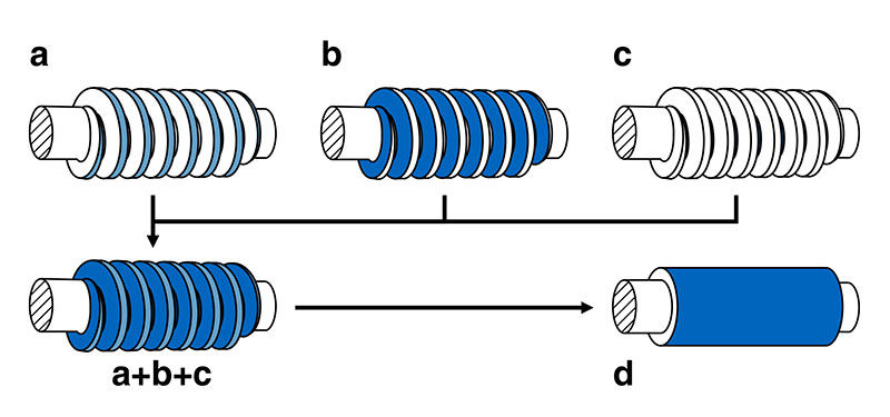

Thermal conductance tooth flank↔oil. When the gearbox is dip-lubricated, a model is needed to calculate thermal conductance between the tooth flank and oil. Since the worm shaft and worm wheel have fundamentally different geometries, distinct models are used depending on the gear in question.
With regard to the worm shaft, a Nusselt correlation of a rotating cylinder according to Changenet et al. (Ref. 4) is used in order to determine the heat transfer coefficient α:
(24)
(25)
(26)
(27)
Figure 4: Simplified surface of the worm shaft (d) consisting of teeth tip surface (a), teeth flank surface (b) and teeth root surface (c).
The interacting surface A is assumed by a simplified surface of the worm shaft consisting of the teeth tip surface (a), teeth flank surface (b) and teeth root surface (c) (Fig. 4). Since the rotation of a simplified cylinder surface will cause less turbulence in the oil than the actual geometry of the worm shaft, an underestimation of the heat transfer coefficient is expected.

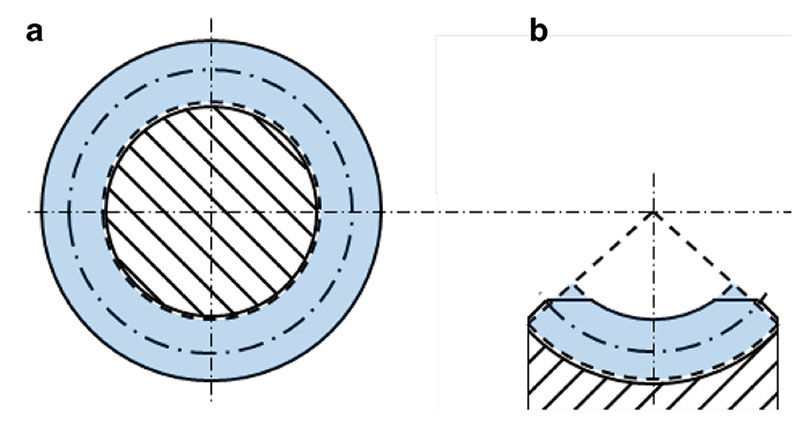

Thermal conductance tooth flank ↔ tooth. The thermal conductance between the tooth flank and the tooth body can be described using the analogue model of heat transfer through a plain wall. The interacting surface is represented by the effective tooth surface Aeff. It is calculated by the active tooth surface Aact multiplied by a factor depending on the gear ratio.
Depending on the gear in question, the active tooth surface is the assumed cumulated tooth contact surface during meshing of either the worm shaft or wheel (cf. Fig. 5).
Figure 5: Assumed active tooth surface of the worm shaft (a) and the worm wheel (b).
Since the worm shaft and the worm wheel have a different number of teeth, a single tooth passes the contact more or less frequently, depending on the gear under consideration. Using the worm shaft as a reference, the teeth of the worm wheel pass the contact less frequently. This means that the time for heat dissipation is greater, which can equally be seen as the transferred heat being distributed over a larger surface. Seitzinger (Ref. 34) investigates the heating of spur gears and develops a simple empirical model that considers this particular issue, using a single factor depending on the gear ratio u. In the simulation program, Eq. (31) is used:
