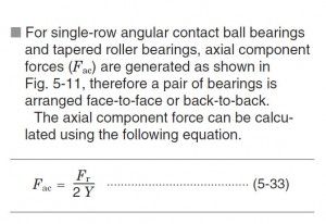

Every bearing that has a non-zero contact angle will generate an axial load as a radial load is applied. This generated load is referred to by a few different names, i.e. — generated axial force, calculated thrust load, or as I first learned it — induced axial load (IAL). The concept is fairly simple; in contact ball bearings or tapered roller bearings, the ball or roller is sitting at an angle. When you add a radial load, you are trying to push the roller down the hill. This generates an axial component that can be substantial.
Usually tucked in an obscure corner of the bearing catalog there will be a vague reference to the IAL with a loose description of how to calculate it and some form of an application description that nobody understands.
Figure 1: Koyo ball & roller bearings p. A38 - B2001E-6.
The basic formula is very simple, though some applications can have non-obvious aspects, which we will cover (Eq. 1).
Where Fac is the IAL, Fr is the applied load and Y1 is the dynamic axial load factor, which is usually found in the catalog line item for the specific bearing. Y1 is just a calculated factor for the convenience of not having to go through the statics of the contact angles of the bearing to calculate the IAC. The bearing companies have done that work for us.
Figure 2: NSK rolling bearings p. B123 - E1102k.

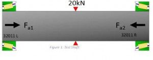

Let’s have a look at a simple example; we will take a 250 mm shaft and put a pair of face-to-face 32011’s on each end and apply a 20 kN load directly on the center of the shaft.
Figure 3: Test shaft.
Now looking at the results in Figure 4, we see the radial load split between the 2 bearings as we would expect with an additional axial load that we did not apply. This is your IAL.
Figure 4: Test shaft loading results.
Let’s see how this compares with our formula (Eq. 2):
That is an easy and obvious result for this example. What isn’t as obvious is that in equally sized and loaded bearing arrangements, this will not affect the dynamic equivalent load P = XFr+YFa, which is what you use to calculate fatigue. See Figure 5 and you see that the equivalent load is still in fact only 10 kN.
