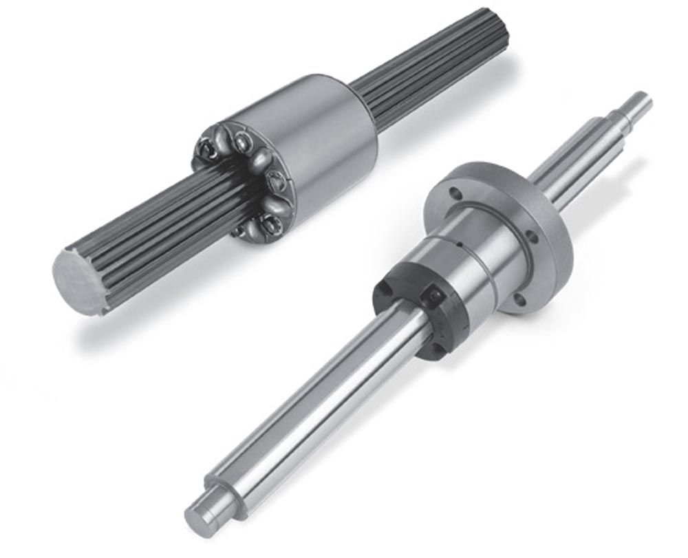

When motion system designers need complex, high-speed, multiaxis motion, they might first think of elaborate, prepackaged robot arms. Or, if they need only a few axes, they might configure a separate profile or round rail for each axis. But hiding between those options is simple and proven ball spline technology. This multiaxis motion solution has existed for years and is still highly relevant to today’s complex motion schemes. Ball splines use a unique architecture integrating rotary and linear motion on a single shaft. This gives them more flexibility to implement complex motion schemes in tighter spaces, providing a two-for-one deal in motion control (Figure 1).
Figure 1—Ball splines, which enable rotary and linear motion on a single shaft, deliver high reliability and life expectancy under varying operating conditions. All figures courtesy of Thomson Industries, Inc.
Integrating Rotary and Linear Motion
Ball splines allow both linear and rotational motion. This is accomplished with a common shaft performing two independent motions (Figure 2). The shaft includes axial ground grooves called “splines” along its length. This also includes a ball spline nut that rides along the axial ground grooves, locking rotational movement or radial moment loads.
Figure 2—Enabling linear and rotary motion on a single shaft, ball splines deliver many benefits to robotic designs, including increased compactness, load capacity, speed, and accuracy.
This article appeared in the March 2024 issue.
To drive the axial rotation, the ball spline nut is turned. This nut houses a series of balls allowing free motion along the axis (i.e., the nut can slide along the shaft with minimal friction). When rotated, these balls apply a perpendicular force to the shaft via the spline cut grooves, turning it.
To drive linear motion, the spline shaft is moved forward or backward using a linear actuator, like a piston. Since the ball bearings roll within the grooves (instead of gliding), a lower coefficient of friction and wear creates a smooth, precise linear movement and higher velocities.
Because of the anchoring/support, this arrangement also resists torsional loading (i.e., the shaft resists rotation unless driven by the motor). If a torsional load is applied externally to the shaft as it is extending/retracting/stationary, the spline nut supports it, resisting that load.
