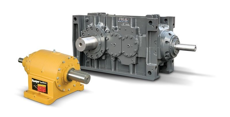

A Rexnord PlanetGear (left) and a Falk V-Class (right) are among the gearing solutions provided by Regal Rexnord.
