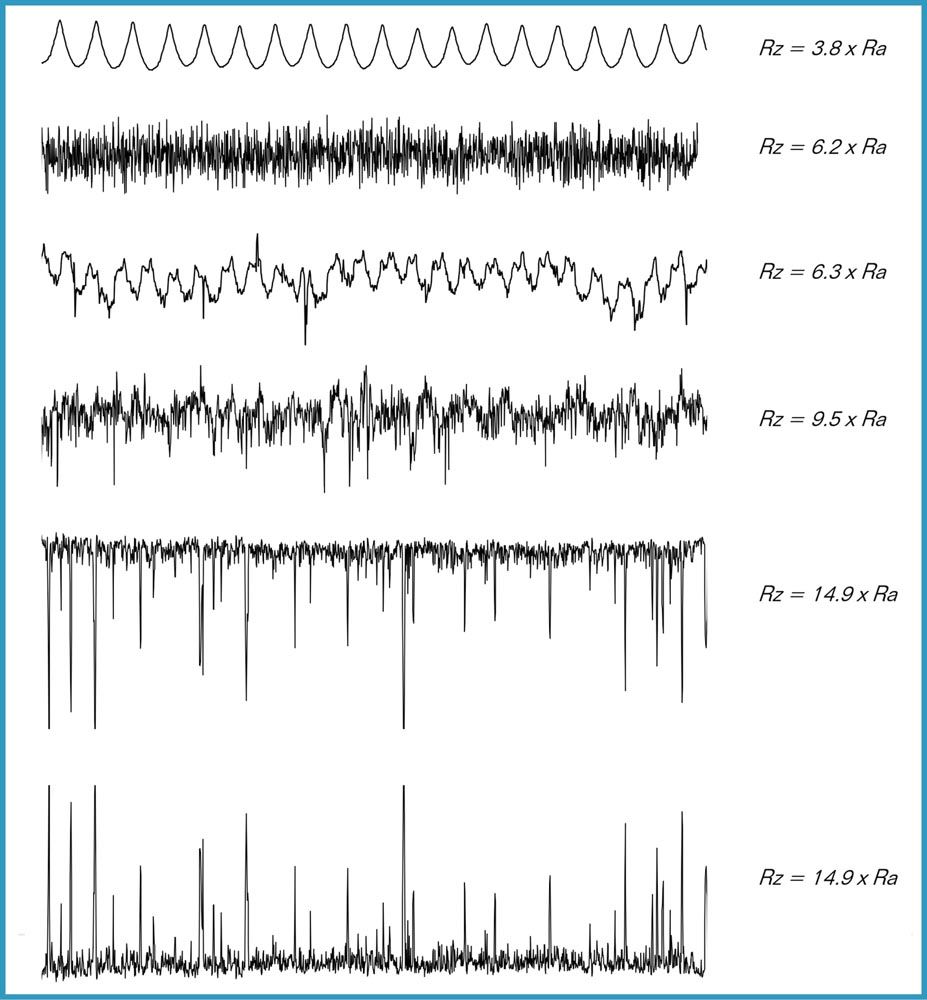

Same Roughness—Very Different Surfaces
Surface roughness is often specified using parameters such as average roughness (Ra), which describes how much the surface deviates from a mean height. A “rougher” surface generally has a larger Ra value.
Figure 3—Very different surfaces, all with the same Ra value. Courtesy of The Surface Texture Answer Book.
The challenge, however, is that very different surfaces can produce the same Ra value. Figure 3 shows five surfaces with the same Ra but very different characteristics. All these surfaces might pass a specification for Ra. But will the component leak or seal? Will it run quietly or chatter, or squeal? Ra may not help us to tell the difference, because it does not differentiate peaks from valleys, or narrow spacings between peaks/valleys from wide spacings. If these aspects of the texture will affect the component’s function, then other surface texture parameters than Ra may need to be specified and tracked.
