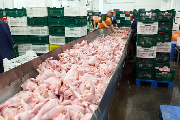

Boston GearA major poultry processing plant in North Carolina faced a difficult challenge on its toughest application – a solid 90-degree transfer. As the conveyor separated whole birds from the main line, birds would bunch up at the 90-degree turn, drastically increasing the torque demand on the conveyor’s motor and speed reducer. Due to direct contact between the partially processed birds and the transfer line, the entire conveyor was also subject to rigorous washdown, adding even more strain. As a result of the high torque demands and frequent washdowns, the conveyor’s existing competitor speed reducer began to fail every other month.
