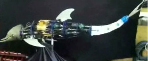

Puppets are the term for characters that interact with guests or actors with the help of human intervention — the puppeteer. A complex puppet typically has multiple puppeteers to handle different aspects of the puppet. Think of the dolphin robot used in several movies. One puppeteer controlled the many actuators involved in the body and tail motions, while another focused on the face, mouth, eyes.

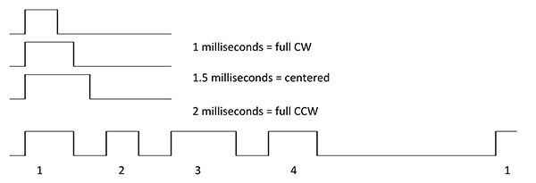

The motions were controlled real-time via RC plane-type controllers; in this case with a wired connection as the dolphin puppet (Fig. 1) was in salt water, which greatly attenuates RF signals. The use of real-time puppets allows for much more life-like interaction with the actors as the puppeteers can improvise with the actors in the shoot. The RC style controllers typically use 1-2 millisecond PWM signals (Fig. 2), with multiple axes multiplexed into a single TTL stream. As high as 20 channels may be commonly multiplexed. This multiplexed stream may be carried via an RF signal or via wires (bottom of Fig. 2). Within the puppet, a demultiplexor splits the single stream into multiple individual PWM connections, with one connection to each servo. The PWM signal can represent either a position (as was used for this puppet) or a speed, such as for the forward motion of an RC-truck. The exact positions can be mapped to PWM duration, and multiple axes can be joined together via the RC-controller so that up-down and left-right can be easily controlled, even though there may be many axes coupled to actually make the motion in a puppet as complex as this one. Typically, 1.5 milliseconds represent the neutral location, with 1 millisecond being one extreme end, and 2 milliseconds being the other extreme range. Some controllers and servos can extend this timing to allow 0.5 milliseconds to 2.5 milliseconds ranges for a bit more accuracy.

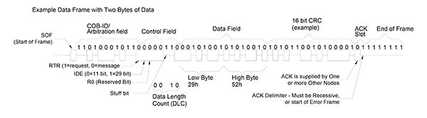

CAN protocol: Many shows and ride props are starting to go over to CAN (Controller Area Network). This protocol originated at Bosch for control of under-the-hood electronic control units, and was designed with multiple levels of protection to help ensure delivery of the correct data. The data is carried as a differential signal, on the CAN-H and CAN-L signal bus. Two electrical states exist on the bus — “Dominant” — which represents a “0” level and has CAN-H driven high and CAN-L driven low, and “Recessive” where none of the nodes is driving the bus, and the terminating resistor pull CAN-H and CAN-L to a small residual differential voltage. Each driver is essentially “diode-or’ed” on the bus, allowing multiple can drivers to simultaneously assert a dominant level without loss of signal. After a quiet (recessive) period between frames, any device with a message to send asserts a dominant start bit. All other devices having a message to send synchronize to this start bit and also assert their own start bits. The identification for the packet — called the COB-ID — is then sent, with each of the devices having a message sending each bit from high to low, while also monitoring the CAN bus. Figure 4 shows three nodes all trying to send a message. As long as each node sees the bus in the same recessive or dominate state that node has driven, the node may proceed to the next bit. If the state does not match, then that node loses the arbitration and must wait for the frame to complete before trying again. This allows the highest priority frame (lowest numbered COB-ID) to proceed on its first try while lower priority messages are delayed until no higher priority message is vying for the bus. Multiple types of frames are defined allowing different modules to communicate in one-to-one communications, as well as one-to-many (or none) broadcasts, and background status (heartbeat) messages as well as network management control. Each frame can carry 0 to 8 bytes of data for basic CAN; newer CAN-FD allows longer data fields up to 64 bytes, as well as higher data rates for the data fields and data CRC portions of the frame. An important aspect is that a particular COB-ID may only be assigned to a single device on the bus to allow proper arbitration.
Figure 5 shows a full frame with 2 bytes of data for the basic CAN signals (non-FD). Not shown in the figure is bit-stuffing: all of the units on the bus resynchronize their timing with each transition of the bus to compensate for differences in their internal clock speeds. To prevent too much drift in their relative timing, the protocol does not allow more than 5 bits of the same polarity before a bit of the opposite polarity is inserted (stuffed) into the frame. These extra bits provide the transitions needed to resynchronize timing between units. These extra bits make the frame time slightly longer dependent upon the data present, and are discarded when the frame is received.

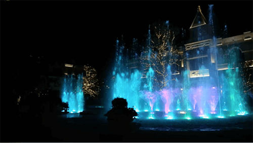

Combination: Multiple communication types may be combined. Figure 6 shows a water fountain show. This application used both DMX and CANopen. The DMX was used for the main show choreography. This included controlling pumps, pointing the fountain head in polar coordinates, setting light colors, and pointing/spinning certain fan type nozzles. CANopen was used to calibrate each station. Each fountain is mounted to concrete set within the fountain. The nozzle needs to be calibrated to compensate for tilt — front and back and side to side. It also needs to be calibrated for rotation so all fountains agree on what is zero degrees — “North.” Calibrating each fountainhead then makes it much easier to program the show rather than having to compensate these variations inside the show itself. This also eases maintenance if a fountain must be replaced. Recalibrate the new fountain head and the show stays the same. The local axes monitored both their primary DMX position slots, some diagnostic control slots, and their paired axis. The two axes interacted via a lever arm, which required adjusting the position of each actuator to compensate for the effects of the lever arm. Again, doing this compensation at the motor controller level allows the show to output desired angles to make programming multiple shows across the many fountains much easier. The CANopen backchannel allows diagnostic functions to run while the show is active without affecting timing of the show.
