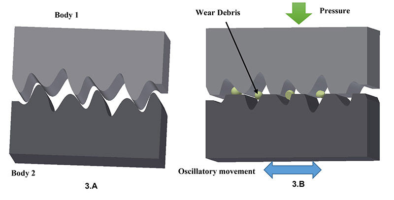

Technically speaking, the fretting wear can occur when a pair of structural elements are in contact under normal load, while cyclic stress and relative movement are forced along the contact surface.
The localized ‘relative movement, which is small and oscillatory, between two ferrous materials is defined as 'slip amplitude’. The slip amplitude is a peak-to-peak amplitude of the relative motion, and it could be as small as 0.25 microns (Ref. 3). In this mechanism, pressure and sliding initialize material adhesion. It is also described as ‘micro-welding’ in the literature. That leads to the material transfer from one surface to the mating one (Fig. 2). Later, the transferred material oxidizes, and its dislodging forms red oxide powder (Fℯ2O3), called hematite (Fig. 3). The powder is formed in presence of oxygen, at room temperature; this powder does not carry magnetic property. Generated particles of the powder are extremely hard, and act as an abrasive.
Figure 2: Microscopic surface asperities of two bodies before making contact (2.A); pressure and movement brake asperities to form wear debris (2.B).
Generation of the powder leads to more clearance between the mating surfaces, and consequentially more intense relative movement. Again, closing the loop, it would increase the rate of powder generation.

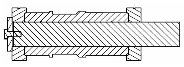

Even though the occurrence and timing of the fretting phenomenon is not quite predictable, once occurred, it is still possible to address it and avoid its further acceleration. Extra attention should be paid to constrain unwanted movements of components. The relative movement of the mating shafts highlighted in Figure 1 can be minimized by clamping shafts axially. Per Author’s experience, the clamping rings added on the both ends of the shaft, as shown in Figure 4, help to align of the shaft help to align the components with each other, and arrest axial as well as radial relative (unwanted) motions.
Figure 4: Constraining unwanted movements on fretted shafts to reduce further wear.
