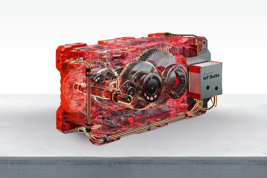

DriveRadar IoT for Gear Units with SEW-Eurodrive
SEW-Eurodrive displayed its DriveRadar IoT Suite condition monitoring and predictive maintenance system for recording and evaluating operating data from industrial gear units at Hannover earlier this year. The IoT Suite makes it possible to reliably predict the behavior of drives and system components and plan maintenance and repair measures in advance, thereby avoiding unplanned downtime.
The DriveRadar IoT Suite uses the operating data it records to determine the condition of industrial gear units and systems.
Data analysis processes can be applied to accurately predict imminent damage. This means that the DriveRadar IoT Suite can prevent unplanned downtime and disruption to operational procedures, identify wear, and minimize idling times.
When utilizing the DriveRadar IoT Suite for industrial gear units, all operationally relevant, mechanical parameters on the industrial gear unit are measured by high-precision sensor technology and then evaluated and interpreted with the aid of machine learning methods. As a result, the customer always has a transparent overview of how healthy the monitored gear units are.
This article appeared in the August 2023 issue.
Analysis algorithms can help allocate anomalies directly to a component, which makes troubleshooting much more straightforward. Besides being notified of any operational anomalies that are detected, customers are also given recommendations on what to do, told which services could help, and issued with predictions regarding the remaining service life of the gear unit, oil, and other components. This means maintenance interventions can be planned at an early stage and spare parts procured in good time, thereby ensuring the industrial gear unit can be operated on a sustainable basis with minimal risk of failure.
The DriveRadar IoT Suite for industrial gear units is available ex-works for new Generation X.e helical and bevel-helical gear units. However, retrofitting is also possible. Industrial gear units that are already installed can be fitted out for monitoring with Drive Radar IoT as well.
