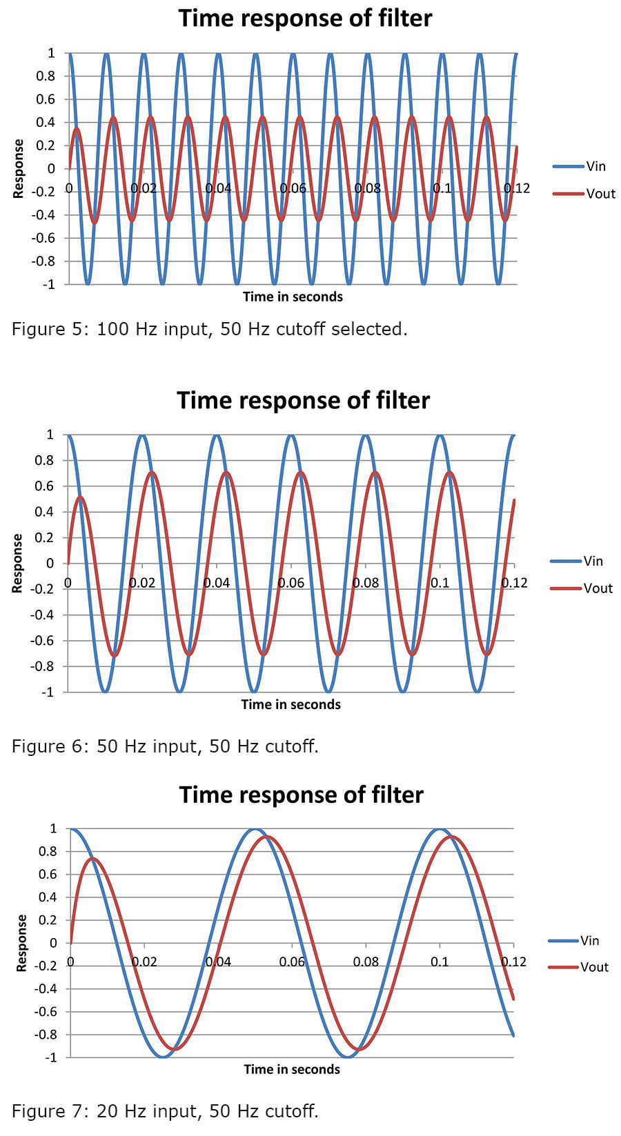

Figure 5 shows a 50 Hz low-pass filter with a 100 Hz input sine wave. There is a slight start up transient when the input is switched on. In the example, the first cycle of input started at peak value but was only on for half of a sine peak before reversing. The filter did not fully charge on the first cycle, so it takes several time constants for the resulting DC offset to settle). The steady state amplitude is
1/((Fin/Fc)2+1).5 = 1/(22+1).5 = .447
When we repeat this with a 50 Hz input to a 50Hz filter, the steady state amplitude is
1/((50/50)2+1).5 = 1/Sqrt(2) = .707
This is the half power point called the cutoff frequency.
We repeat with a 20 Hz input into a 50Hz filter and we get a steady state response amplitude of:
1/ ((20/50)2+1).5 = 0.928 (Fig. 7)
Each of these filters is included as a sheet in the spread sheet referenced above. You can change the selected cutoff frequency and input frequency. The sampling time in the spread sheet is 120uS, which corresponds to the filters used in our QuickSilver products. This corresponds to 8,333 Hz. The input frequency for this implementation should remain below 4166 Hz (½ sampling rate) for proper operation.

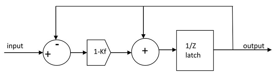

Calculating Kf for the desired cutoff frequency

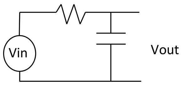

For the analog version, consider the capacitor is charged to 1v, and at time=0 we attach the resistor.
The natural (decay) response for the RC circuit will be V(t)=Vo×e–(t/RC), a simple exponential decay.

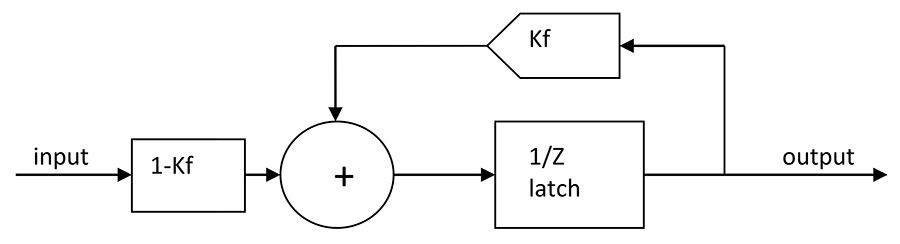

We can do the same for the digital circuit by loading the register holding the estimate to 1 while keeping the simulated input voltage at zero. The output would start at 1. At the next sample period the output would be 1 × Kƒ = Kƒ. The 2nd sample period it would become Kƒ×Kƒ = Kƒ2 at the second sample period. In general, it would drop to Kƒn at sample interval n. Time(n) = sample period × n = 120e–6 × n for this particular filter.
Going back to the the analog filter we are simulating: this filter has a natural response (for an initial charge voltage =1) of
v(t)=e–(t/RC) = e–(2×PI×Fc×t)
where the cutoff frequency Fc = 1/(2×PI×RC) => RC = 1/(2×PI×Fc)
If we set the transient output for the time series equal to the transient output for the analog filter (looking only at the sampled times),
e–(2×PI×Fc×t) = Kƒ(t/Ts)
Where Ts is the sample time and Fc is as defined above, we can take the natural log of both sides, isolate Kf, and then take the natural antilog of both sides and we have:
Kƒ = e(–2×Pi×Fc×Ts)
This calculation is shown in cell F4 of the respective worksheets.

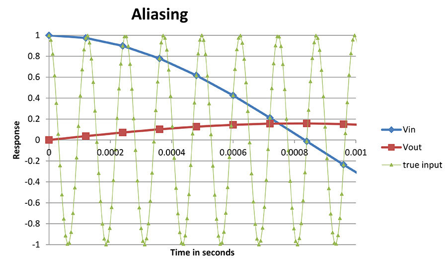

Limits of simulation. This simple model of the low-pass filter works well as long as there are enough samples compared to the frequency components in the input. For inputs containing frequencies of more than half the sample frequency, an effect known as “aliasing” will occur, which will cause frequencies in the output that are different from those that were applied to the input (down-mixing for those familiar). These are normally not desired and should normally be avoided. (Aliasing = one frequency taking on an alias as a different frequency due to the sampling process.) Carefully controlled aliasing can be used to mix RF frequencies to an IF by proper sampling, so this effect can be used effectively. But the total bandwidth of the input signal still needs to be limited to prevent unwanted mixing!
This aliasing effect may be seen in movies showing the propeller of an airplane or the blades of a helicopter that appear to stop spinning or to reverse direction. In the case of the movie, the camera is commonly at 24 frames-per-second for film (often other speeds for electronically captured videos). If a propeller is spinning right at 24 revolutions per second (1,440 rpm) the camera catches successive rotations of the propeller on each subsequent frame, making the propeller appear to be stationary. A little faster and the propeller will appear to be slowly turning forward, a little slower and the blade will appear to reverse direction. A serious issue may occur if older fluorescent lighting (non-electronic ballast) are powered from a single phase (all flashing at 120Hz) in a machine shop. When observing a tool connected to a synchronous motor, the strobe effect of all of the lights flashing at rotational rate of the motor may cause the tool to appear to be stationary when it is actually spinning. An induction motor with a small slip can appear to be moving slowly. In both cases the strobing lights may make the rotating device appear safe to touch! This is one of the reasons that the fluorescent lighting was normally wired with adjacent lights wired to successive phases of 3-phase power in machine shops. The combined light would thus always have one or more of the sets of lights glowing, which eliminates the strobe effect that would otherwise make the spinning parts appear to be slow or stopped.
Sampling a fast-moving waveform can cause the same effects for the sampled data. In Figure 8 the input wave form is 8.033kHz and is sampled at 8.333 kHz. The sampling is less than twice the frequency component of the waveform, so the sampling causes mixing between the actual waveform and various harmonics of the sampling rate. In this case, the first harmonic of 8,333 Hz sampling rate is mixed with the 8,033 Hz signal, resulting in a 300 Hz mixing, which then is filtered and shows up in the data.
Figure 8: Aliasing: sampling an 8.033 kHz waveform at 8333 Hz.
The green “true input” shows this data if it was sampled 20x faster. The blue “Vin” diamond that overlaps the green arrowhead shows those points of the actual data that gets collected by the sampling at a rate that is less than twice the input data frequency.
Although no 300 Hz signal was present in the input waveform, this 300 Hz aliasing artifact shows up. Although the 50Hz filter should have almost completely filtered out an 8kHz signal, a significant 300 Hz signal appears at the output of the filter. If this is a control system, significant mechanical problems can result! If the input noise is near the sampling frequency, the alias can show up as a DC baseline that is varying around, which is essentially impossible to filter out.
This issue can be addressed by filtering the analog input with a continuous filter or by sampling at a much higher frequency, filtering sufficiently to remove the high frequency components, and then down-sampling (decimating) the data prior to subsequent processing at a lower processing rate.
