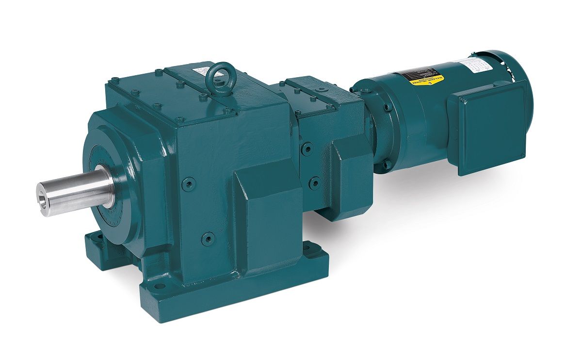

Where will the gearmotor output be oriented compared to the motor? The most common arrangements are inline and right angle. An inline gearmotor will have the output in line with the motor (see photo, page 14), while the right-angle version may have the output to the right or left, up or down when compared with the motor position. The mounting position refers to how the gearmotor will be mounted: will the feet/body be up, down, right or left? The mounting position must be known when selecting to ensure the internal lubrication is properly oriented for the gearing.

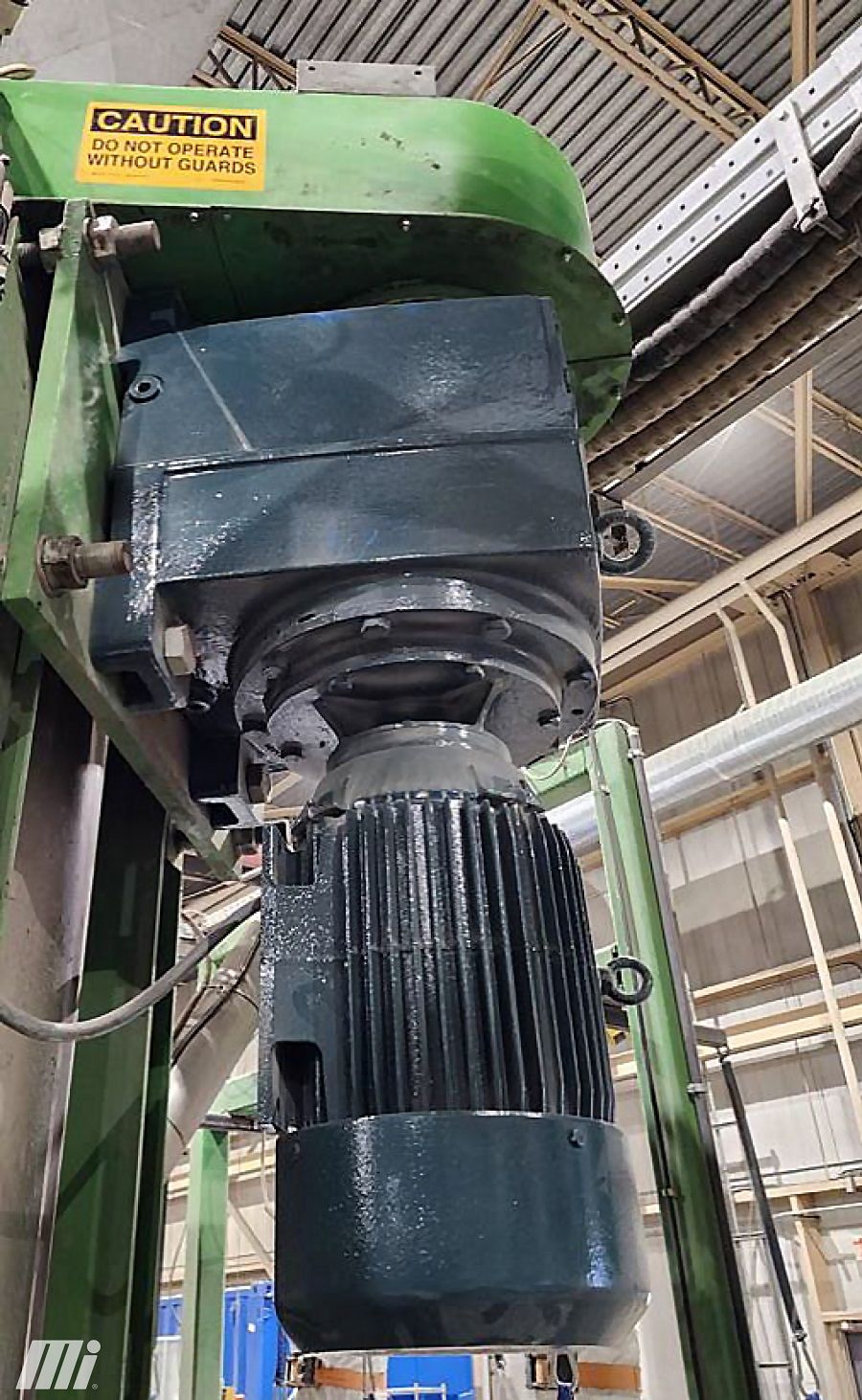

At their core, gearmotors are a combination of a gearbox and a motor. While some gearmotors are neat, compact packages with the smallest overall length, the manufacturers have designed each piece integral to each other so if a maintenance problem exists, it impacts the whole unit. Another approach is to combine two separate units and make a gearmotor (see photo, left). That is, if one takes a gearbox with a C-face or coupled input and combines it mechanically with a standard NEMA or IEC motor, this design still qualifies as a gearmotor.
Each design (the integral unit vs. the combined unit) has its pros and cons when reviewing their use and application. The compact integral design allows for a smaller footprint and use in tight locations. It also provides for one inventory SKU and requires minimal setup. In contrast, the combined design consists of the gearbox and motor representing two individual SKUs, which can cause mounting issues when a coupling design is used. However, if one piece of the unit fails, it can be replaced quickly as the separate parts are more readily available, and only that section is required. Both gearmotor designs provide similar performance, yet their mounting requirements and availability could impact which makes the most sense for the application.
