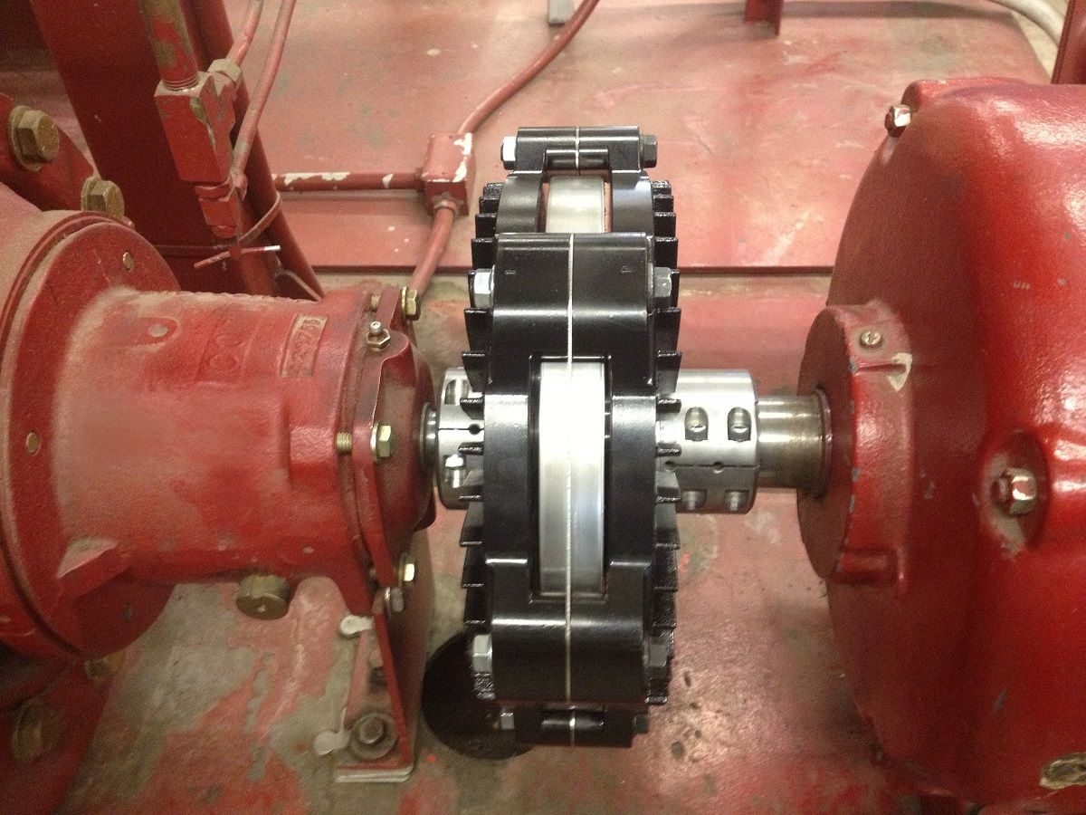

Magnetic couplings in service.

From my experience, I have discovered that the best way to deal with slow seasonal thermal growth is to use a shaft coupling with no connection between the driver and driven.
Does this exist? Yes it does: think magnets!
Magnetic couplings depend on an air-gap and powerful magnets between the driver and driven. They are one of our industry’s best-kept secrets. If they had a lower cost, they would be more mainstream so they need to be solving an equipment issue to be considered. The air gap is not a physical connection, so if the equipment shifts seasonally within the magnetic couplings’ ability, then the misalignment is absorbed and not passed to the bearings or other parts of the machine.
Magnetic couplings solve another issue as well. If we need a soft start between driver and driven to absorb start-up or a shock load. This is a market which fluid couplings have targeted and done very well. A fluid coupling will not solve a thermal growth issue and it requires transmission fluid to be inside the coupling. No shaft coupling can handle both issues articulated in this article as effectively as a magnetic coupling.
  • Magnetic couplings will create a slight bit of speed slip so this needs to be taken into consideration
  • Magnetic couplings can handle massive misalignment, as shown here, up to .300”
