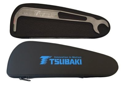

The new BS Large Size Indicator is available in sizes RS20B to RS48B and the ANSI Large Size Indicator – covers sizes from RS100 to RS240. These complement the existing BS Set which is used with sizes RF06B to RS16B and the ANSI Set for sizes RS35 to RS80. The new large size indicators are available to purchase as individual items, rather than as part of a set.
The Tsubaki Chain Wear Indicator enables plant and machinery engineers to measure roller chain condition and determine critical wear in one simple operation. In use one end is shaped to fit snuggly over a roller and the tip of the other end indicates the degree of wear by highlighting the total elongation over a number of links. As such, they are a valuable tool for helping keep machinery in top condition and for minimizing unexpected chain failures that could lead to costly production downtime.
