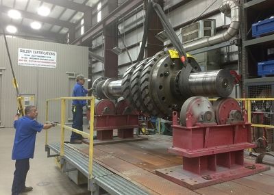

The size and weight of a large turbine like the 501F places particular demands on any maintenance provider. Disassembly, inspection, repair, balancing and reassembly operations all require large and highly specialized equipment. To accommodate these requirements, Sulzer has invested in two dedicated 25,000 ft2 large turbine overhaul facilities. Equipped with a 100-ton capacity crane with 50 ft of space under the hook, these facilities also use a vertical pit and scissor lift for rotor stacking and unstacking operations, together with a 180,000 lb capacity balancing machine and a horizontal lathe with a 198,000 lb capacity.
The overhaul work scope on a machine as large and complex as the 501F is determined by the customer’s requirements and the operating history of the equipment. Typically, a service will begin with disassembly and inspection of the full rotor unit followed by cleaning, non-destructive testing (NDT) and life-cycle assessment.
When issues are identified during turbine operation or the inspection process, significant engineering work is often required to identify and implement a robust, cost-effective solution. For example, one machine was shut down and brought to a Sulzer service center after it exhibited significant vibration. Inspection revealed high radial run-out of up to 0.18 inches. Upon disassembly, it was found that the register fit on the forward stub had broken off completely.
