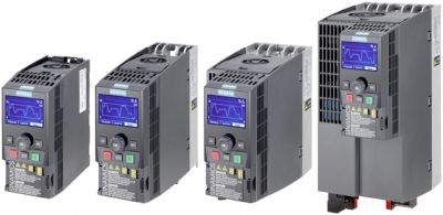

Siemens recently announced the availability of its Sinamics G120C drive in AA size, which replaces the previous G120C frame size A in power ratings up to 2.2 kW (3 hp), including communication variants for USS, Profibus, Profinet and EtherNet/IP. Offering high power density in a smaller footprint, the new “tiny drive” offers fully compatible replacement for the equivalent power ratings on the previous version.
On new control cabinet designs, the G120C FSAA has significant size advantages, up to 32 percent less overall volume, for the OEM or integrator, but requires no re-engineering, when migrating from the G120C FSA on current jobs. Overall dimensions on the smaller unit, designed for use with Profibus and USS variants are only 173 mm high x 73 mm wide x 155 mm deep (6.8" x 2.8" x 6.1").
