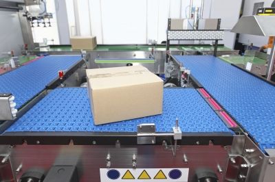

Promat highlights System Plast roller-top and heavy-duty belt
System Plast engineers a wide variety of conveyor belt and chain for low-maintenance, high-efficiency performance, utilizing proprietary polymer formulations to suit application requirements. Demonstrating its flexibility at Promat, Regal will demonstrate its directionally unlimited roller top belt that can align products to any angle, divert them, sort to multiple lanes, rotate, combine, or gap them – all done softly without contact. System Plast 2253RT roller top belt simplifies conveyor design and installation with its independently controlled moving surface that easily handles large or small, flat-bottom products, moving them on half-inch (12.5 mm) balls spaced on one inch (25.4 mm) centers. It supports loads up to 617 lb/ft (9,000 Nm/m) or 1.1 lb/ball (0.5 kg/ball). The belt's non-contact product manipulation eliminates impact and abrasion damage from pushers, as well as the need for mechanical adjustment or changeovers for conventional diverters or guides.
