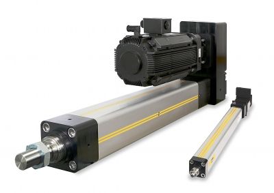

Parker’s Electromechanical Automation Division, a supplier of motion control technology, recently announced the release of the ETH125 electric cylinder.
The ETH125 is the fifth and largest frame size in the series and expands this line of industrial cylinder product to serve a broader range of application requirements.
The ETH is the next generation of electric thrust cylinder product and utilizes a new integrated drive train and guidance design that has enabled Parker to maximize the overall thrust capacity within a smaller overall footprint. With the development of the 125 mm frame size, Parker’s ETH now spans a thrust range up to 114,000 N (25,618 lbs).
ETH high force electric cylinder features maximized thrust density and precision position control, oversized ball screw and thrust bearings and IP54 rated as standard with options for IP65 and higher.
