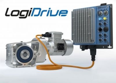

LOGIDRIVE is designed for vertical, horizontal, and inclined conveyors, the LOGIDRIVE system features a modular two-stage helical bevel gear unit, IE4 motor, and a decentralized variable frequency drive (VFD). All common field bus and industrial Ethernet interfaces are integrated into these drive units. The use of IE4 synchronous motors minimizes overall lifecycle costs. Efficient operation at partial load and low speeds make this the ideal solution for high-volume manufacturing, warehousing, and packaging systems.
