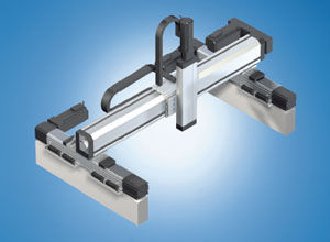

Bridge Modules Span Long Unsupported Lengths
The BKK and BKR Bridge Modules are an expansion of Rexroth’s linear modules. The aluminum extruded profile provides high torque stiffness to reduce deflection where the module is not completely supported. Y axes for gantry systems are an example of this where the bridge modules replace the configuration of parallel linear modules.
Inside the aluminum extrusion are two ball rail systems with four steel runner blocks at a 90-degree angle to increase load capacity. They are completely enclosed with an aluminum cover and polyurethane sealing strips. The BKR belt-driven model comes in length variations up to 8,000 mm. The BKK ball screw-driven model is suitable for higher thrust forces and lengths up to 5,500 mm, and it is available with ball screw supports for even higher speeds at longer lengths.

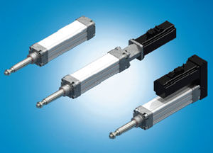

Electromechanical cylinders will also be at the Rexroth booth. These provide high thrust, high-speed capabilities flexibly and with control to applications that use hydraulic or pneumatic cylinders. They are corrosion-resistant and suited for packaging and material handling applications as well as assembly and robotics, wood manufacturing, metal forming, plastics, paper converting and web handling, according to the company’s press release.
A ball screw actuator in the electromechanical cylinders eliminates stick-slip effects while providing precise positioning and high repeatability. They are more environmentally friendly than hydraulics due to the level of efficiency and low-maintenance they offer. The cylinders come in six sizes from 32 mm to 100 with stroke lengths up to 2,000 mm and up to 1.6 m/sec in speed. They have the same connection dimensions as an ISO 15552 pneumatic cylinder, so they can be placed into traditional pneumatic applications. They allow for direct and parallel motor mounting, several rod end, flange, trunnion and clevis mounting options as well as step and servo motor options.

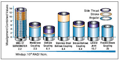

Electrodeposited Bellows Provide High-Frequency Interconnection
The PMG electrodeposited bellows are an alternative to spring-loaded type test pins in high-frequency test applications. The electro-deposition process allows for bellows to be made of different materials including gold, nickel, copper and silver, which increases the bellows’ conductivity and provides low DC resistance with minimal insertion loss. They are rated for a maximum current of 4 amps and are capable of lifetime spring and force repeatability (108 cycles).
Servometer’s PMG bellows perform in long-life applications with flexibility, precision and maximum sealing. They offer one-piece construction and have no moving parts, so they prevent resistance or impedance factors. They are available as small as 0.5 mm diameters with .008 mm walls for PCB applications, and shape options are unlimited. The thin walls lower rotational inertia, which results in minimal drive power losses during intermittent operation. The electro-deposition’s geometric construction allows the bellows to fit more convolutions in a given length than hydro-formed bellows, according to the company.
The concentricity of the electrodeposited bellows is held to within 12.7 µm. They exhibit no cyclic speed variation through 360 degrees rotation, and the bellows’ can potentially last for 108 life cycles. Servometer can coat the bellows with noise reduction materials if necessary. The bellows are ROHS compliant and can be used in instrumentation, laser, medical, aerospace, solar, semiconductor, vacuum and oil machinery applications.

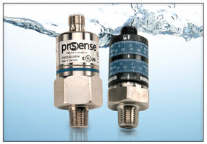

ProSense pressure sensors will also be on hand at the Autmotion Direct booth. They are vacuum pressure sensors, an alternative to mechanical switches, and they monitor system pressure in hydraulic and pneumatic applications. They use capacitive sensing and strain gauge technologies.
The stainless-steel housed PTD series vacuum transmitters convert system pressure into an analog output signal. Output options include 4 to 20mA or 0 to 10 volts and offer up to 1,000 psi. They have a flexible film circuit, and a ceramic sensing element for overpressure protection.
The PSD series electronic pressure switches perceive gas and liquid pressure up to 5,800 psi using a 316 stainless steel process connection and gas-tight measuring cell. The sensors can adjust without system pressure or supply voltage, so calibration is unnecessary. The PSD series has a switching life of 50 million cycles and features a dual-switching DC output.

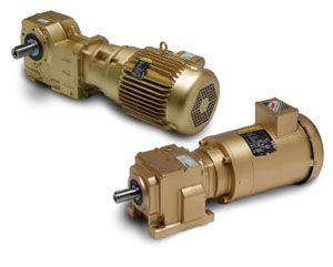

The Dodge Quantis Gold C-face gearmotor combines the Baldor Reliance Super-E Premium Efficient Motor with the Quantis in-line helical (IHL) or right angle helical bevel (RHB) reducers to produce a complete gearmotor package that maximizes energy efficiency. Configurations up to 10 hp are available.
The Quantis ILH and RHB features include NEMA clamp-collar design, foot-mounted housing, standard inch output shafts, nitrile output and output lip seals, A1 mounting and Mobilegear 600 XP 220 oil. The RHB unit also offers flange mounted housing configurations and tapered hollow bores with twin-tapered bushings, according to the company’s press release.
The Baldor Reliance Super-E Premium Efficient Motors are constructed with rolled steel and cast iron, and they feature TEFC enclosures, 1,800 rpm, 60 Hz and voltages ranging from 230 to 460 V. They are inverter capable for variable-torque inverter drives and 20:1 constant-torque applications. They were designed to perform in dusty, dirty and humid environments.

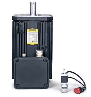

Baldor is also exhibiting a high-power brushless servo motor. The BSM132 runs up to 20 hp with the option of blower cooling, allowing up to 34 hp. Speed up to 5,000 rpm is possible, and the servo motors have continuous stall torque from 70 Nm to 120 Nm. The BSM132 is sealed against dust and low-pressure water jets. Feedback includes resolver or absolute encoder and a double-insulated, multicoated magnet wire for reliability. Applications include those that require high-power, accurate positioning such as packaging, food processing, beverages, material handling, shearing and printing.
