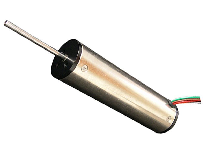

New, metric and imperial dimensioned electric cylinders or linear voice coil servo actuators have been released by Moticont.  The new, compact 25.4 mm (1.000 in.) stroke SDLM-025-095-01-01M and SDLM-025-095-01-01 Linear DC Servo Actuators feature high repeatability, high acceleration/deceleration, and zero cogging!  These high force-to-size Electric Cylinders have linear encoders mounted internally for closed loop servo operation. Additionally, to operate at peak efficiency, integral temperature sensors provide data to achieve the highest possible throughputs.
The clean fully enclosed SDLM-025-095-01-01M and SDLM-025-095-01-01 Servo Actuators are 25.4 mm (1.000 in.) in diameter, the housing is 95.3 mm (3.750 in.) long and the total length of the housings and shafts are 139.7 mm (5.500 in.).  The 3.2 mm (0.125 in.) non-rotating shafts have M2.2X0.45 x 5.1 min DP or 2-56 UNC-28 x 0.20 min DP threaded holes, for direct, zero backlash connections to a load at either end.  The shafts are supported at both ends by long life plain linear bearings and can tolerate side loads up to 2.0 N (7.2 oz.). These clean, quiet linear actuators have a HOME sensor. They are ideal for: medical, assembly, workholding and clamping, sorting, laser machining and drilling, packaging, sampling, scanning, laser beam steering and filtering applications.  A complete Plug-and-Play servo controller is also available.
If there is a need for a smaller or larger diameter linear servo actuator, one with longer travel, more force, Imperial or Metric, select from the many choices available in this expanding family of SDLM linear motors based on size, length of stroke, and force.
