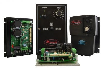

Minarik Drives has introduced the MDBL Series, a new family of versatile, feature-rich, configurable controls for brushless DC motors. MDBL drives control motors ranging from 90 to 280 VDC, up to 5 amps/1.5 HP, using either 115 VAC or 230 VAC line sources. On-board trim pots allow operators to quickly set minimum/maximum speeds, acceleration/deceleration rates, motoring and regening current limits, as well as the proportional and integral feedback gains.
An onboard microprocessor allows for custom programming the MDBL Series – for tasks as simple as changing the purpose of a jumper or trim pot, or as complex as programming an entire application-specific routine. The MDBL also seamlessly integrates PLC-like functionality into operations, eliminating the need for a separate PLC altogether or enhancing systems without PLCs. These controls are positioning-application capable, with feedback sampling rates of 16Khz. Each drive is designed for feedback from 120° hall effect sensors and can be commanded with a wide range of analog inputs with Minarik Drives’ built-in isolation.
