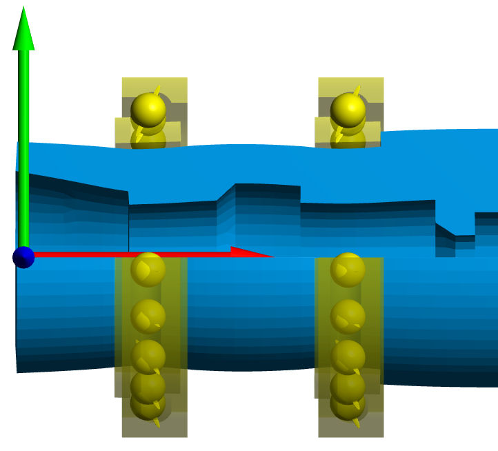

Color plots for 3D-deformations
Based on a customer request a color plot for displacement fields was now added for MESYS Shaft Calculation version 08/2021. Color plots for harmonic response, stresses or equivalent radiated power had been available before.
