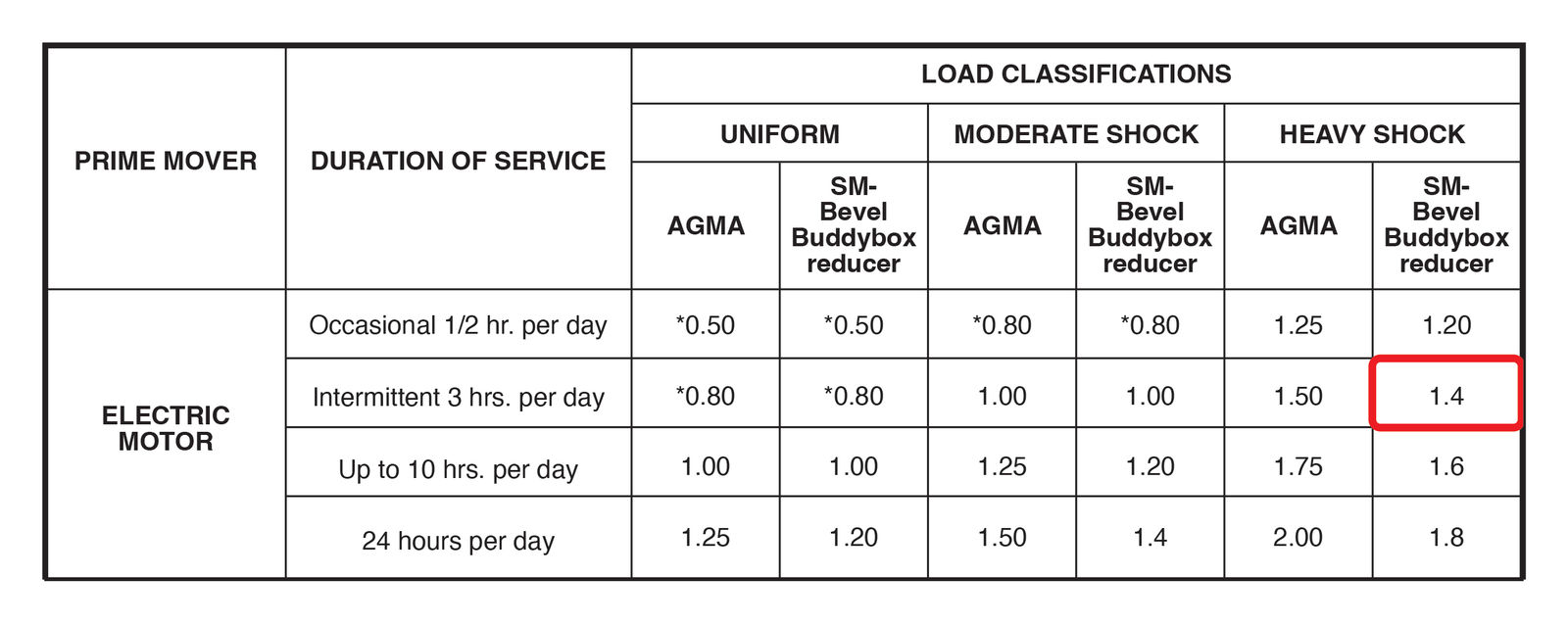

Based on Sumitomo's load classification for selection (Figure 2), a service factor (SF) of 1.4 is required for heavy shock load and intermittent duty (3 hours per day) applications. SF is calculated as the capacity of the gearbox divided by the motor power. Considering a 10 HP motor, the gearbox’s capacity should be equal or exceed 14 HP. The Sumitomo gearbox model KHFJS-D4165-R1-62 was selected as it meets all requirements. A breakdown of the application’s requirements is laid out on the following sections.
This article appeared in the September 2023 issue.
AGMA_Figure2.jpgFigure 2: Load classification based on Sumitomo's experience.

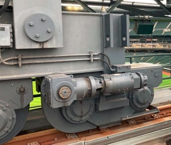

The retractable roof is towed by 128 wheels powered by 96 10 HP electric motors [1] that travels through rails and wheels similar to those of a train (Figure 3). Under ideal conditions, the gearbox experiences uniform load. However, as the roof is meant to be used during inclement weather, the gearbox can experience heavy shock loads and variable loading due to wind speed.

Figure3.jpgFigure 3: Retractable roof's wheel drive.

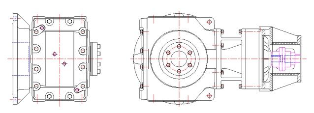

The gearbox is mounted horizontally using a flange that bolts onto the structure (Figure 4). It features Sumitomo's Taper Grip Bushing (TGB), a keyless output connection that eliminates the need for precision machining of the driven shaft during installation (Figure 5).
 Figure 4: Flange-mount Bevel Buddy Box in horizontal position. Left: side view. Right: back view.

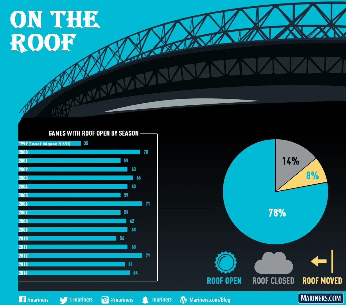

From 1999 until 2014, the Seattle Mariners played 1,262 regular season games [2] (Figure 6). Even though Seattle has a reputation to be a rainy city, most games were played with the roof open. In this 15-year time period, only 173 games were played with the roof closed, and 104 times the roof was operated during the game. It can be concluded that the roof was deployed for game-related events an average of 18 to 19 times per year. If other reasons are considered (non-game events, field maintenance, roof maintenance, and training), roof deployments may vary from 250 to 400 per year.
The intermittent nature of the roof's operation helps prolong the lifespan of the gearbox. However, it's important to note that when the roof is operated in poor weather conditions, it can result in heavy shock loads that put a strain on the gearboxes. To account for this potential overload, the appropriate service factor was carefully chosen.
WP-Sumitomo-JTD-Figure-6.jpgFigure 6: Games with roof open by season from 1999 to 2012 [2].

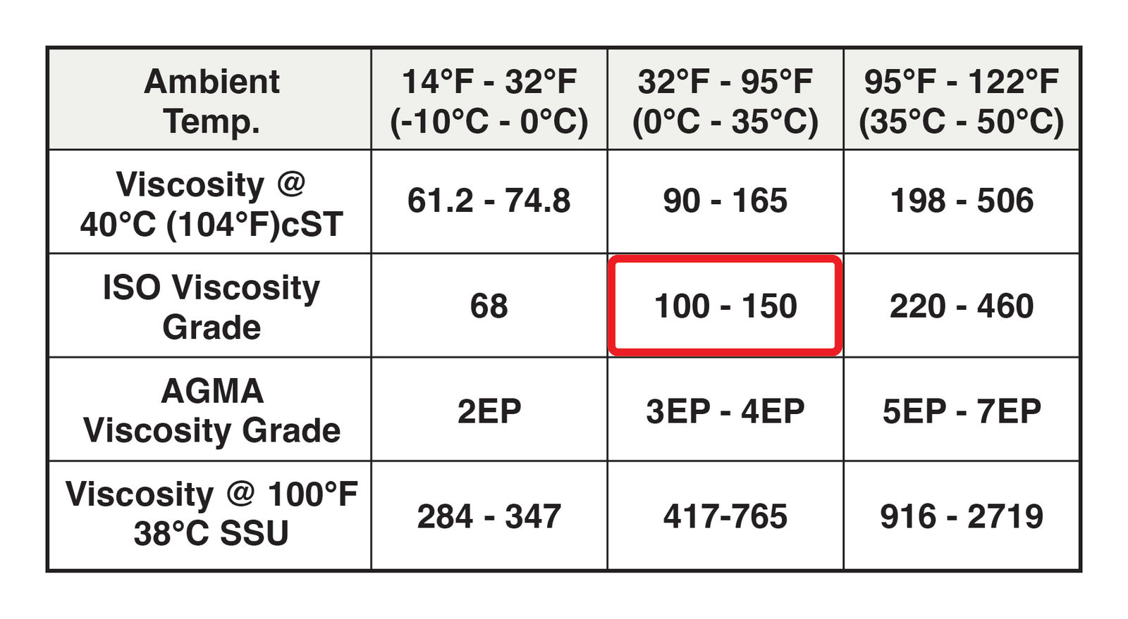

Considering an ambient temperature range of 35 to 76 °F (~2 to 24 °C), it is recommended to use a gear oil with ISO viscosity grade of either 100 or 150 cSt (Figure 7). Mobile SHC 627 oil with viscosity grade of 100 cSt was used in the Sumitomo gearboxes, as this gear oil provides sufficient oil film thickness on hot days and does not affect start-up during cold days.
Figure7.jpgFigure 7: Recommended oil viscosity for SM Bevel Buddybox and Cyclo.

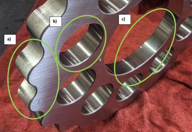

A couple of gearboxes were found leaking which prompted the Mariners’ stadium maintenance staff to reach out to Sumitomo to inspect them. It was recommended by Sumitomo’s Sales team to do a preventive inspection in order to avoid failure of the gearbox during service. The exterior of the gearbox does not show any defects other than the leakage found on a couple of units (Figure 8). The interior of the components showed only minor wear. The Cyclo reduction components (Figure 9) were found to be in an almost new condition. After over 24 years of gearbox operation, it is likely to find spalling on the eccentric cam or micro pitting on the disc lobes. In this case, none of these two failure modes was found, and the reduction components were deemed re-usable.

Figure9.jpgFigure 9: Condition of the Cyclo discs. a) Cyclo discs' lobes show mild polishing. b) Low-speed shaft pin's contact surfaces' and c) eccentric bearing's outer race both show mild abrasion.

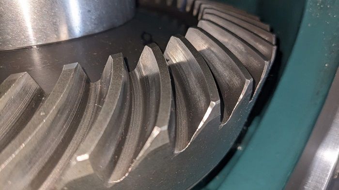

As for the bevel gears, no failure modes other than minor abrasion was found (Figure 10). The bevel gears usually operate at lower speeds than the Cyclo portion, so the minor wear will not represent an issue. The bevel gears were also deemed re-useable.
10a-web.jpgFigure 10a: Bevel gear set condition. a) bevel pinion shows mild polishing.
 10b-web.jpgFigure 10b: Bevel gear set condition b) bevel gear shows mild polishing.
Aside from checking for the condition of the reduction components, it is a standard practice for Sumitomo’s Repair Team to do an overhaul of the unit. An overhaul would include the replacement of normal wear and tear items such as seals and bearings. Additionally, it was recommended to replace input and output shafts in order to avoid components with minor rust, in order to facilitate installation.

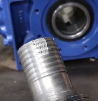

Finally, the use of Sumitomo's Taper Grip Bushing as an output connection reduces the failure rate and increases service time. In contrast, Keyed Hollow Bore installations have a small clearance between the hollow bore and driven shaft, which can result in fretting corrosion due to the rubbing of the driven shaft against the hollow bore. This can damage the hollow bore, driven shaft, and seals, leading to increased failure rates. Thanks to the friction operating principle of Sumitomo's Taper Grip Bushing, the hollow bore clamps onto the driven shaft, eliminating the risk of fretting corrosion and reducing the energy required to remove and replace the gearbox.
Figure11.jpgFigure 11: Anti-seize paste used in a minimal surface area for Sumitomo's Taper Grip Bushing.

After over 24 years in service, the condition of the gearbox was deemed re-usable. Seals and bearings were replaced as it is recommended during overhaul. Input and output shafts were recommended to be replaced in order to facilitate future installations.
