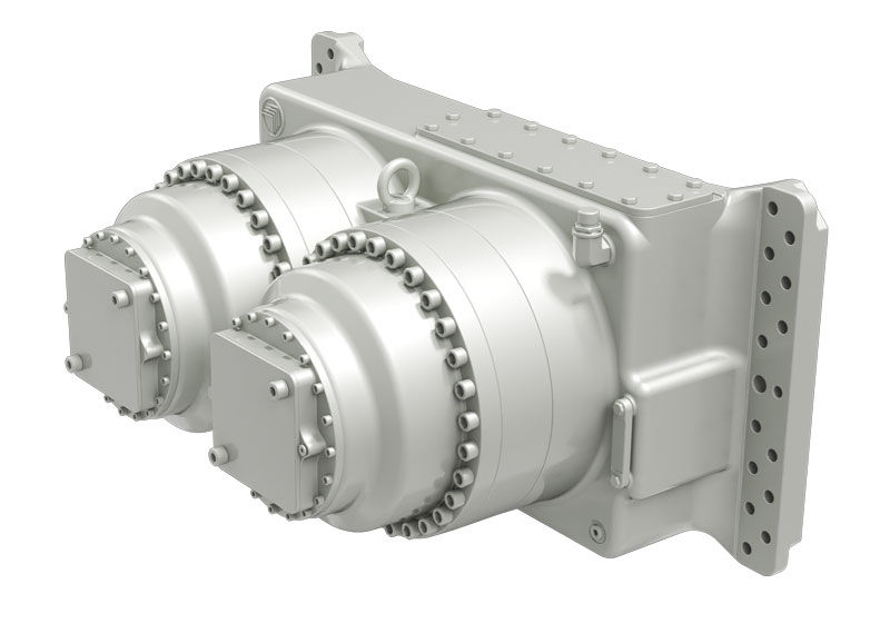

bonfiglioli1.jpgThis kind of product modularity and flexibility is found in Bonfiglioli’s Planetary Series (300).  The 300 series is compact and powerful, excelling in areas where shock loads and impacts are more the rule than the exception. The product configuration is highly versatile, due to several options for mounting, gear layout, output shaft and motor interface.

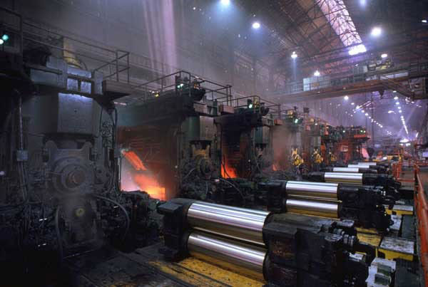

Delroyd Worm Gear Solves Drive Failure for Screwdown Mill Stands
The gear drives for screwdown mill stands at a major steel mill in Ohio were failing prematurely causing extensive downtime. The worm gear teeth were wearing and breaking down at an accelerated rate due to improper meshing at the contact zone. The problem created excessive pressure at the gear’s pitch line/contact zone.
delroyd1.jpgDelroyd engineers met with the hot mill managers to conduct an on-site inspection and short-term mill stand monitoring period. Through these efforts, it was determined that the cause of the drive failures was that three different gearing manufacturers had supplied gearing, all with different thread designs, which were being mixed and matched over time.
A spare worm and gear sample was sent to the Delroyd facility so that a new gearing solution could be reverse engineered to ensure that all gear sets installed on the hot mill stands would have a matching thread/tooth design. The new Delroyd gearing solution extended the gearing life from six months to more than six years.
