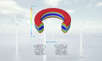

Freudenberg Sealing Technologies has now developed a method that takes material changes at the molecular level into account when predicting the long-term durability of seals. The new methodology is more reliable than previous models and ensure fewer materials to be used.

Freudenberg’s material experts used a dual approach to develop a new process. They significantly improved the service life model by coupling chemical oxidation equations – for example, the oxygen attack on the elastomer – with the structural-mechanical behavior of the material. In order to efficiently calculate any possible geometry, the new method was numerically based and employed a commercial finite element program. It is now possible to calculate local oxidation processes and their effect on materials’ mechanical behaviors using the Freudenberg method.
At the same time, Freudenberg experts also further developed the measurement methods used to determine the parameters for the material model – to calculate the amount of oxygen consumed during the aging process, for example. The amount of oxygen is an important parameter for estimating the extent of the chemical attack.
